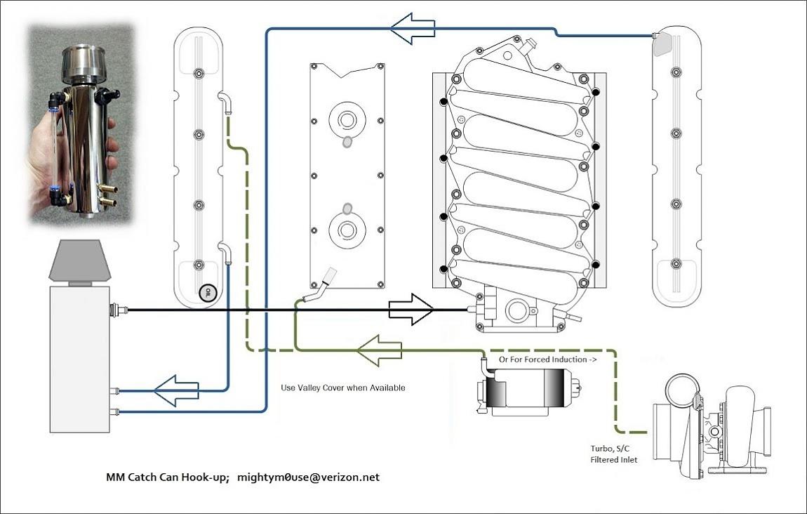

Here's a schematic of the set up
https://www.performancetrucks.net/fo...can-image-jpg:
Is this the setup you are running? so do you need 2 catch cans or one? This is the most confused I have ever been about anything.

From: OH
i've been running this setup for 2 yrs now, works great. i usually drain the can every couple hundred miles. i'm in boost a lot tho. driver side is basically stock w/ vented catch can. passenger side take the line on front of the valve cover and move it to behind air filter for turbo. cap it off where you took it off the tb. the filter on the oil filler is just used for extra venting, not a have to. simple as it gets. don't make it more difficult than it is.
I dont know why but this just made something click in my head and i now understand how it will work. Thanks for the help!!!!
