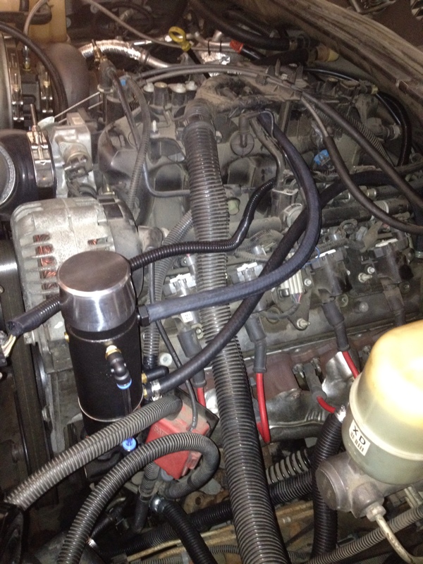

I run a sealed catch can with a check valve between the intake and can. I run the fresh air side to the elbow in front of the turbo. Works rather well. I have about 500 miles with the setup and i have no oil i. The intake elbow before the turbo.
I had a check valve on the clean air side as seen in the puc below but it has been removed
Pic if the Boomba check valve

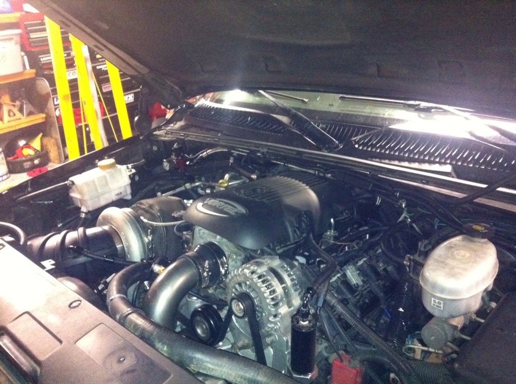

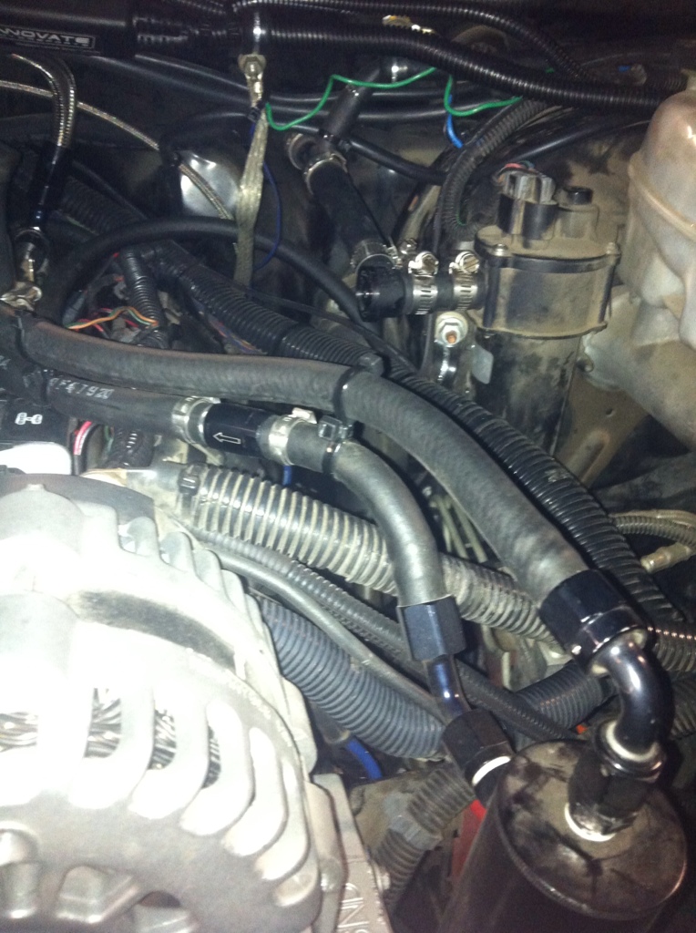

Because I want POSITIVE crankcase ventilation. If you run the lines to the can with no vacuum it's just venting but not sucking the fumes out. In that case, just run breathers on the valve covers.
I just got my can mounted. Yes, it's a vented catch can, but it only vents when the can is under positive pressure. Under vacuum the can is sealed.
And like BlackGMC I tapped my intake filter and am routing it to the passenger valve cover. The TB port is capped off.
