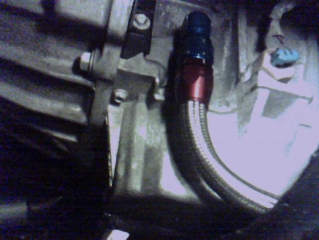

well its been a long road to success but its almost here. the oil sandwhich we were going to use for feed and return didnt work as the tech at transdapt told us it would.. we reluctantly drilled the pan for our return and added a tilton scavenge pump.. as is well now.. zippy from the ss forum came out to the shop tonight and put a temporary tune on it one that is good enough to get me to the exhaust shop tomorrow and get me to autorama this weekend.. it runs actually pretty good on the tune now.. zippy is coming back out the 21st of this month to put the final touches on the truck.. here is a pic we took with a camara phone of the pan tapped. hope for some better pics at the show this weekend and as promised i will have some sound clips very very soon...
