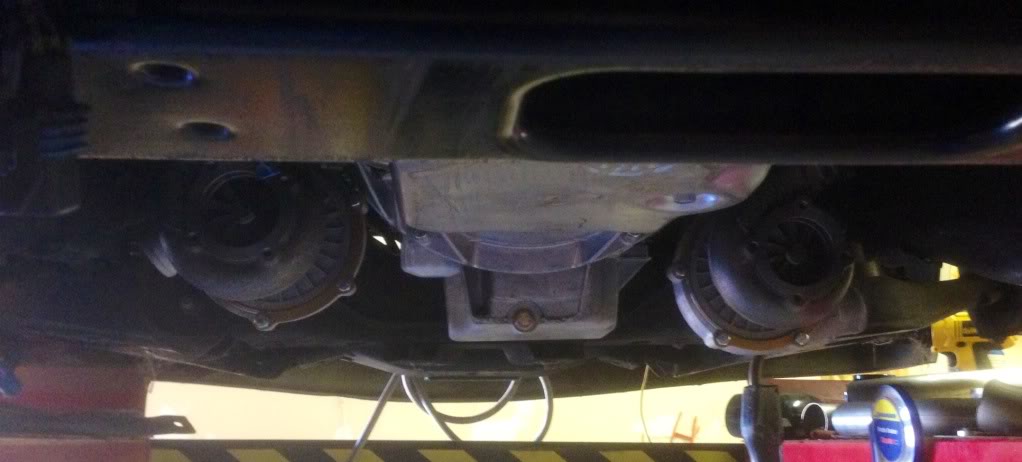

Twins low mount no engine compartment headaches.
