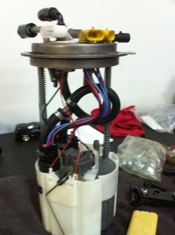

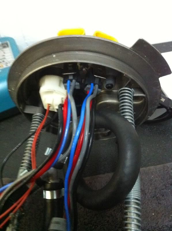

Well we stayed late and did a little work. Got the whole front back together and this built. Almost ready to get the tank back in there and wire everything up. Matt took the connectors to the pumps apart and re wired and crimped and soldered them so there were no breaks in the wires inside the tank. I had to put the big loop in it because it had compresses down so much that I couldn't run it straight off the Y to the pumps but it will work.

Where did you get the "Y" pipe from?
Old Nov 19, 2010 | 03:17 PM
  #27
2toneblown's Avatar
Posts: 1,398
From: Lewisville, TX
Lightning Force Performance

From: cedar bluff,alabama
What kind of hose is that? When I did my single install I used fuel injection rated rubber hose from Napa.... it came apart and left me stranded. I went back with the the oem type of line.
Old Nov 19, 2010 | 05:08 PM
  #30
2toneblown's Avatar
Posts: 1,398
Gates submersible fuel line. Kinda expensive but it's what works.
