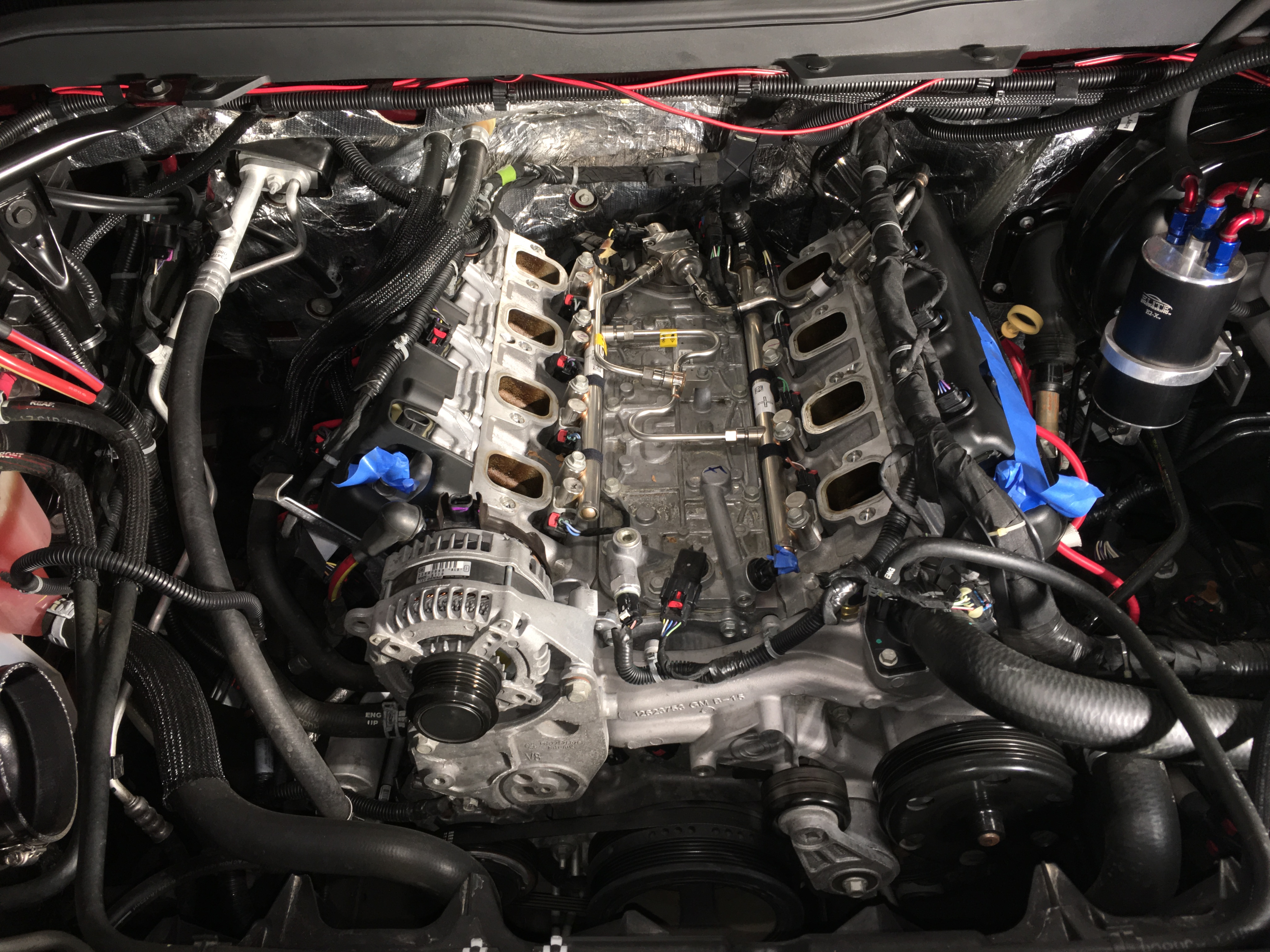

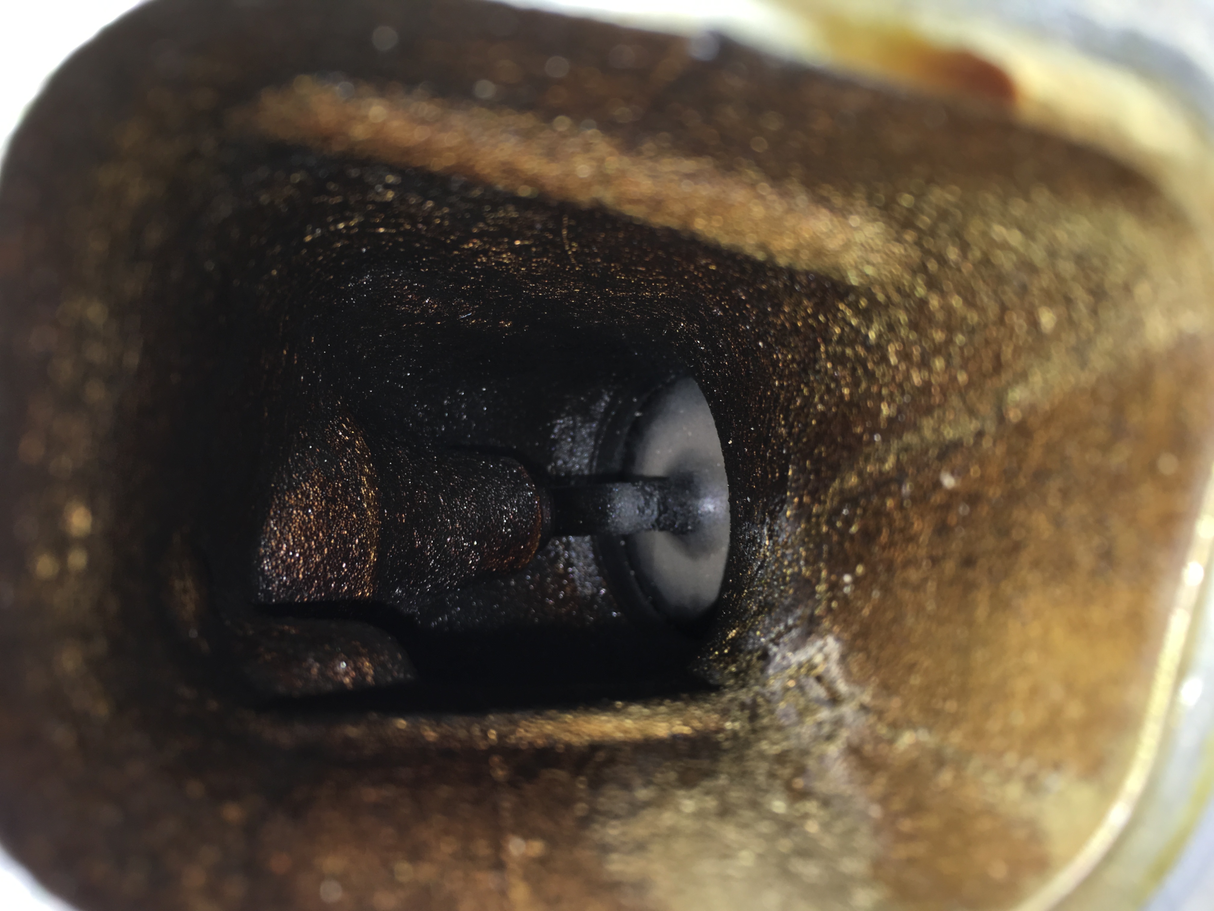

some updates. started disassembly. whipple goes in tomorrow. as you can see in the picture of the intake valve, i probably should have installed the catch can from day 1.

My God those intake ports are shitty. How many miles are on this thing?

17,000 miles. Catch can was installed at 9,000.

Meth injection will help keep em clean...
Damn. Thats the exact reason why I don't hook the cans back up to the intake. **** that.
