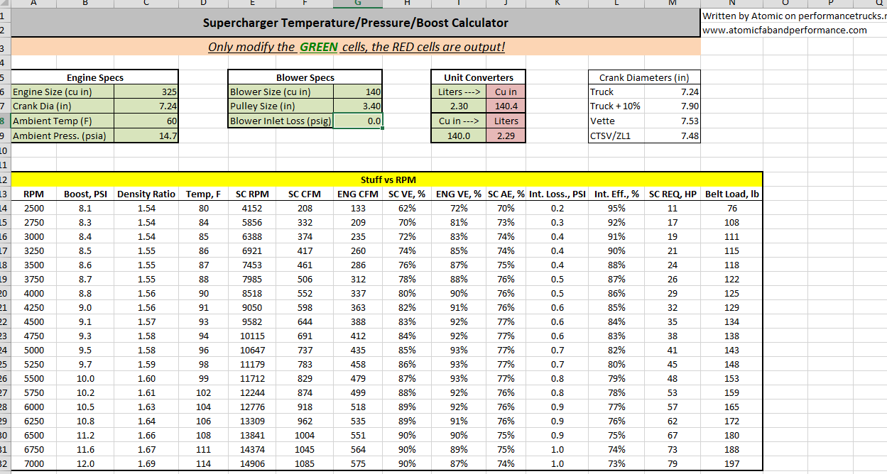

Searched, but couldn't find what I needed. I've got a 2010 aluminum 5.3 (799 heads, 10:1 compression) with an LS6 cam in a 2006 Colorado. 1 3/4" longtube headers, 2.5" true duals. Stock truck crank pulley (pinned). I've got a 3.4" pulley right now which came with the blower. Truck will run E85. Has head studs and LS9 gaskets. I'm looking to not go with an 8-rib setup so I want to keep the boost reasonable. Truck has a McLeod RST clutch and T56 trans. I was hoping to make around 9-10lbs (or maybe a bit lower?). Will my 3.4" pulley get me there or will I need a 3.6"? Right now I've got dual 100mm idler pullies and I plan on a Gates belt. Right now primarily worried about pulley size. Looking to make 550whp/550wtq give or take.

The 3.4 should be around 9psi and the 3.6" around 7psi.
5.3, stock crank pulley, 2300 w/ 3.4" pulley

Thanks! I had downloaded that spreadsheet ions ago but couldn't find it.

@Atomic sorry to dredge up old posts. I have your spreadsheet downloaded and am looking at it and had a question.
I'll also be putting a 2300 on a 5.3
I have a "jack shaft" 2300
I see your spreadsheet has cells in the lower right to calculate for this, but I don't note any change in the rest of the table when I input that.
So, I've just been taking pulley diameter and multiplying by .86 because the jackshaft has that for an underdrive ratio
Is this how you'd recommend I do it for proper calcs in your table? the SC rpm matches up when done that way so I believe it to be the right way to go about it.

plugging that into your fantastic excel grid, that looks like it should net 6-7 psi
flipping the rear pullies around to have a 1.16 OD would have me at around 16 psi (I think that's a bit much!)
So, I'll plan on leaving the 3.2 and the .86 UD rear setup
any guesses on what that might make for AWD hp?
Am I using your excel sheet properly?

Yes that is fine. That jackshaft calculator part is basically just to find an equivalent conventional pulley setup, then youll use that size in the main part of the spreadsheet. Hard to say how much power, but a cammed 5.3 at 7psi would probably be in the 450rwhp range.

but getting back to your original question, inputting the front & rear pulley sizes in green gives you the non-jackshaft number to use up top (which calculates as if it was a direct drive unit). also don't forget to account for your elevation's typical barometric pressure; 14.7 is standard for sea level, but up here where i live is ~13.8 and will change the expected boost numbers.
