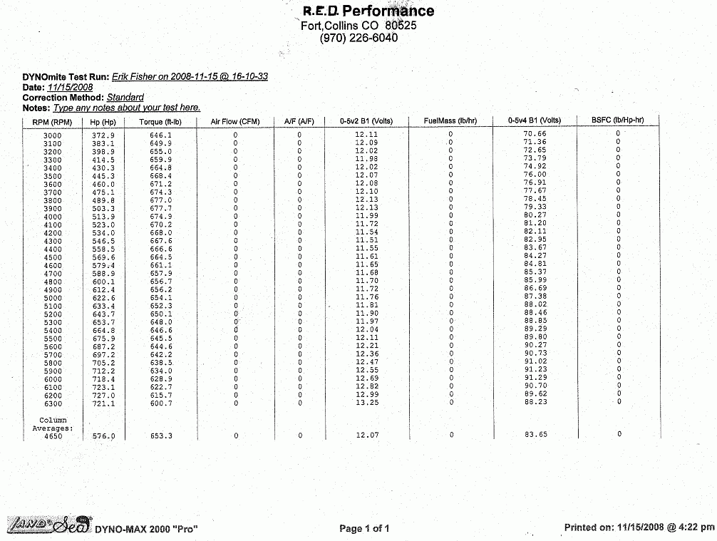

Old Feb 11, 2010 | 11:37 PM
fish5225's Avatar
Joined: Jul 2006
Posts: 134
From: Colorado
I put the 1900 on a forged 408. Here is the dyno chart at 6lbs of boost. Ported 243's, 601 lift cam with 90mm throttle body.
