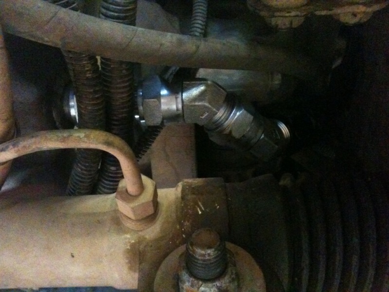

Really late on this.. but i welded a -12 bung on the side of the pan and made it work

Seeing as I need a drain point myself, what's against using the oil drain hole in the pan? Why does it need to be above the oil level? Seems to me even if the oil was built up in the hose to the top of the oil level gravity would cause it to flow anyway.

Hmm... that's a good point, the oil level in the drain hose will stay the same as that in the pan. But that's a lot of hose to run to get to the oil pan drain hose. Perhaps there can't be a solid wall of fluid in the hose for some reason.

Using the oil drain hole I don't think will work well.
In theory the oil will be at the same level.
But since it's not water oil flows slower.
Once the draining oil hits the oil level in the hose it will start backing up in the hose.faster then it's decreasing.
But that's just what think will happen. If y'all try it and it works we could easily buildca fittng that would take the place of the drain plug and still allow the drain to work.

On our kits the turbo is not hi enough. Tried it about 3 years ago. Worked on level ground. But hit a small incline and smoked bad.
It's not a big deal,to drill and tap the pan.
I have had several customers ask about using an electric oil pump to return oil to vc. Just so they wouldn't have to drill and tap. But when they here the cost of a pump. They end up drilling the pan.

The turbo needs gravity to drain. If the valve cover is near the same height as where the oil drains from the turbo, then gravity won't be as effective in getting the oil away from the turbo. Valve cover is fine if you have a pump like the STS kits.
