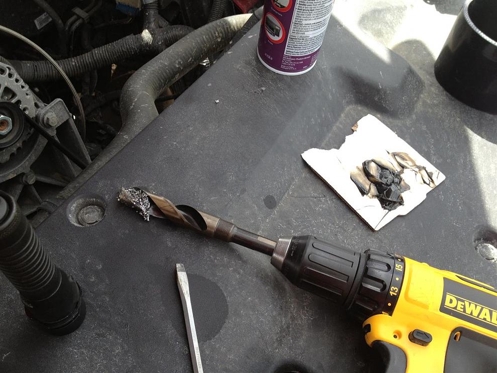

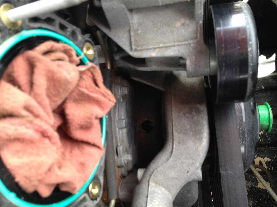

I took mine to the timing chain cover.
I had a lot of room at the top of the front cover to make a connection.
Being very careful and using a lot of grease while working slowly I managed a hole in the top of the case that I threaded to 1/2" NPT (once again, using a lot of grease).
I flattened out the flow across the hose since the pics but the end of the outlet nipple is about 2" above the top of the inlet nipple. Got 1500 miles on it with no problems whatsoever.
