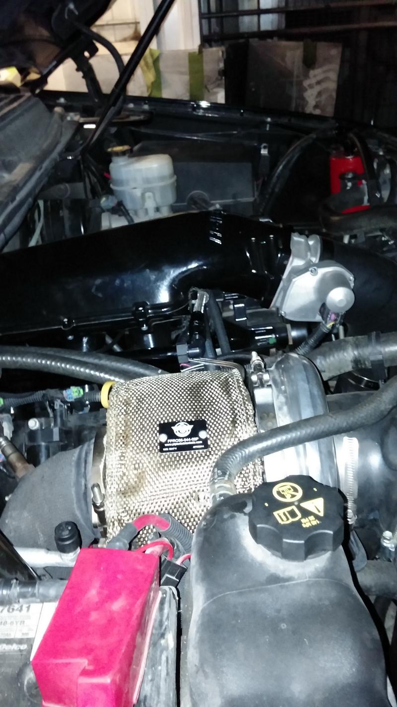

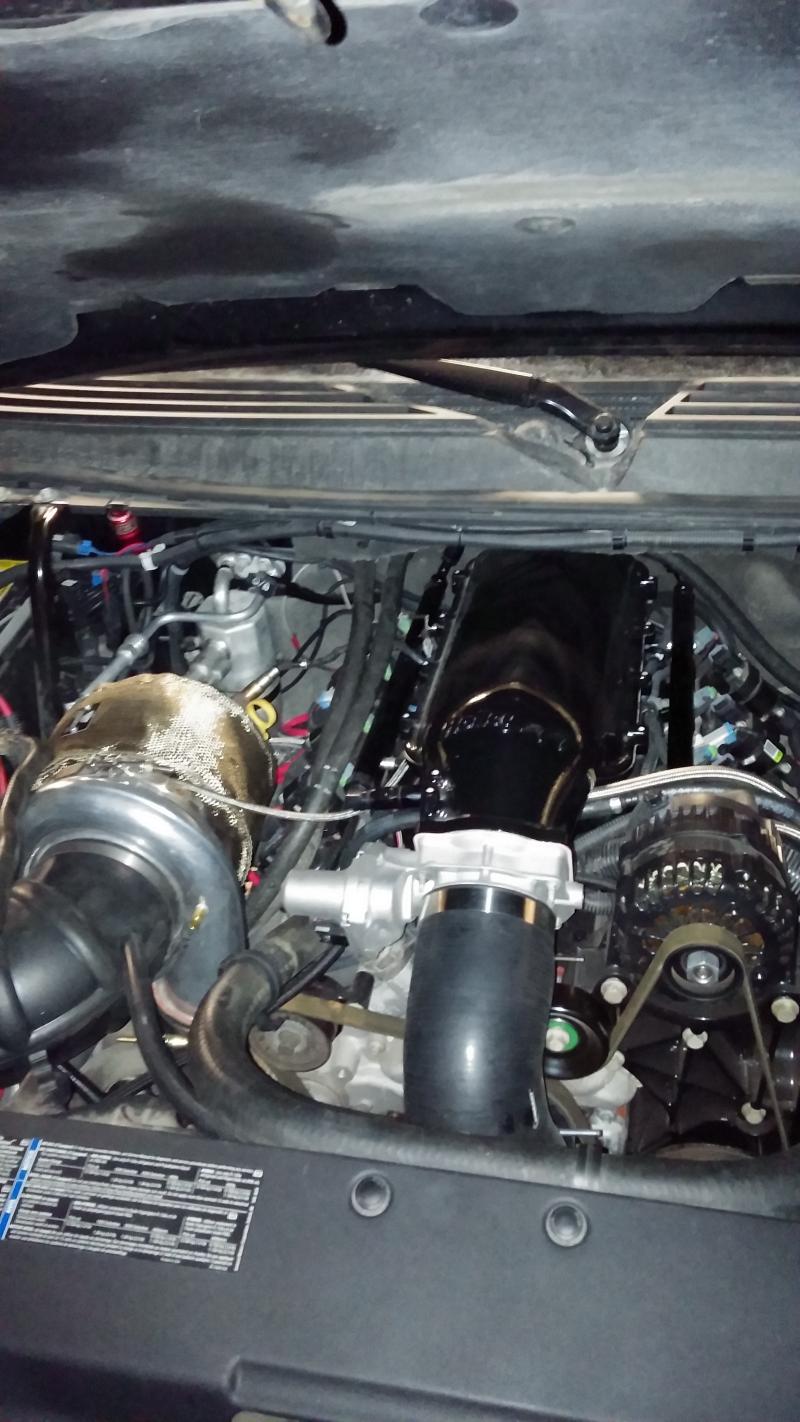

What did you do with the big wiring harness??? More pics of the harness routing.

What's that little hose going to the air filter elbow?
Mark it gets routed under the intake manifold between the runners. Looks really clean.
That's for the RX monster Catch can.
