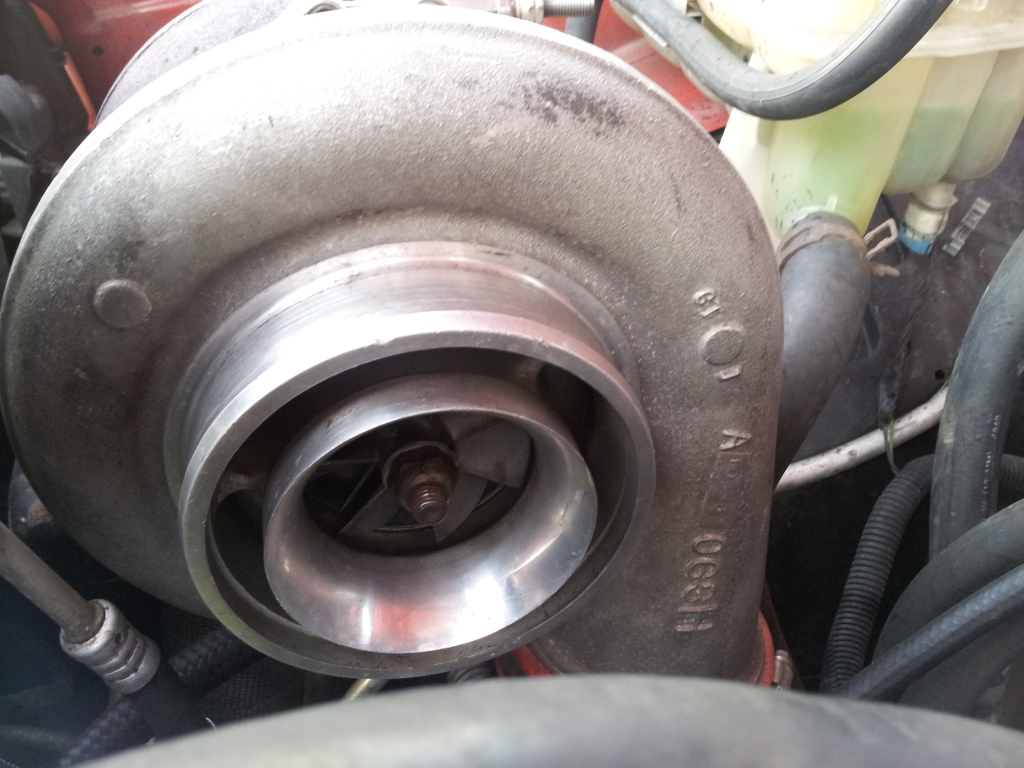

Hey guys was told my truck had a bw s475 on it but im just not sure can anybody read some numbers on there turbos
Mine says GT something 063h

Picture?

I've never seen a BW compressor cover like that before,. Can you read the number on the exhaust housing?

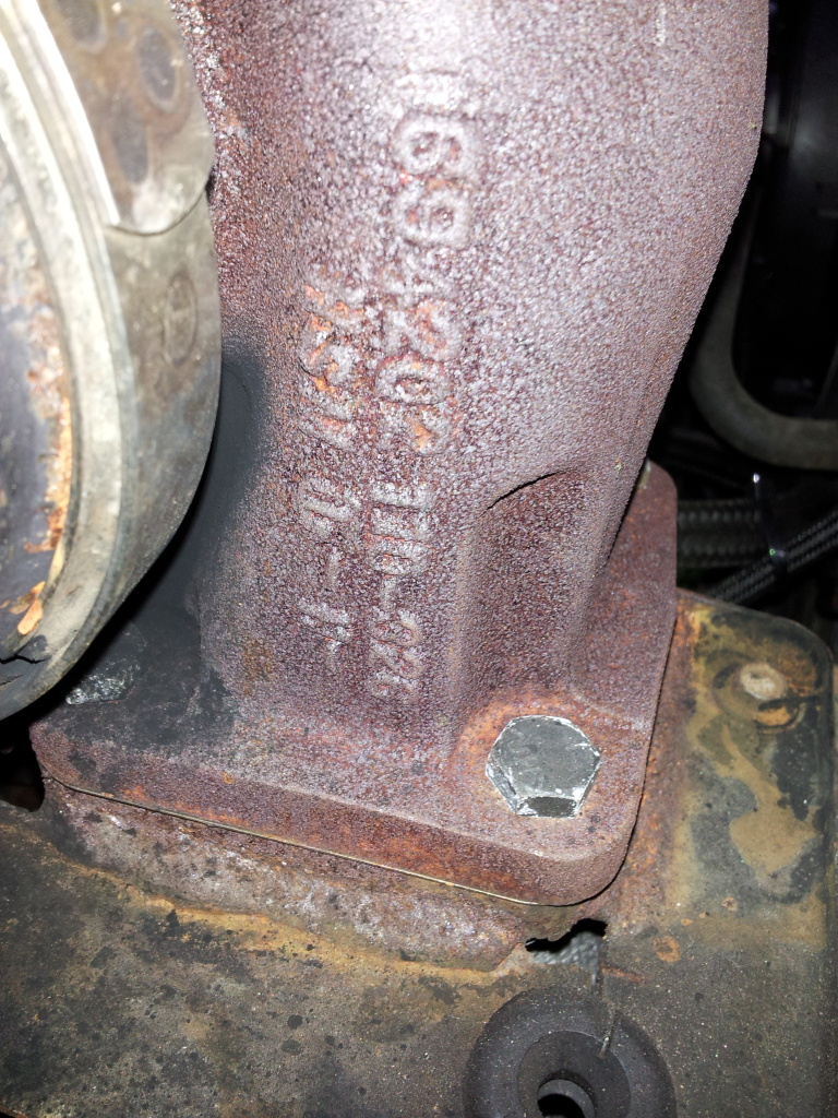

Measure the compressor wheel.

That turbine housing seems to be a BW 1.10 a/r 83mm housing so that's a good sign

The markings on the compressor housing look the same as this one: https://ls1tech.com/forums/attachmen...mg_2993-2-.jpg

The one on the LS1tech ad is the cover that I am used to seeing. It is the standard cover. Notice the G instead of H and also notice the inlet, It is straight, unlike the the flared one the OP has posted
