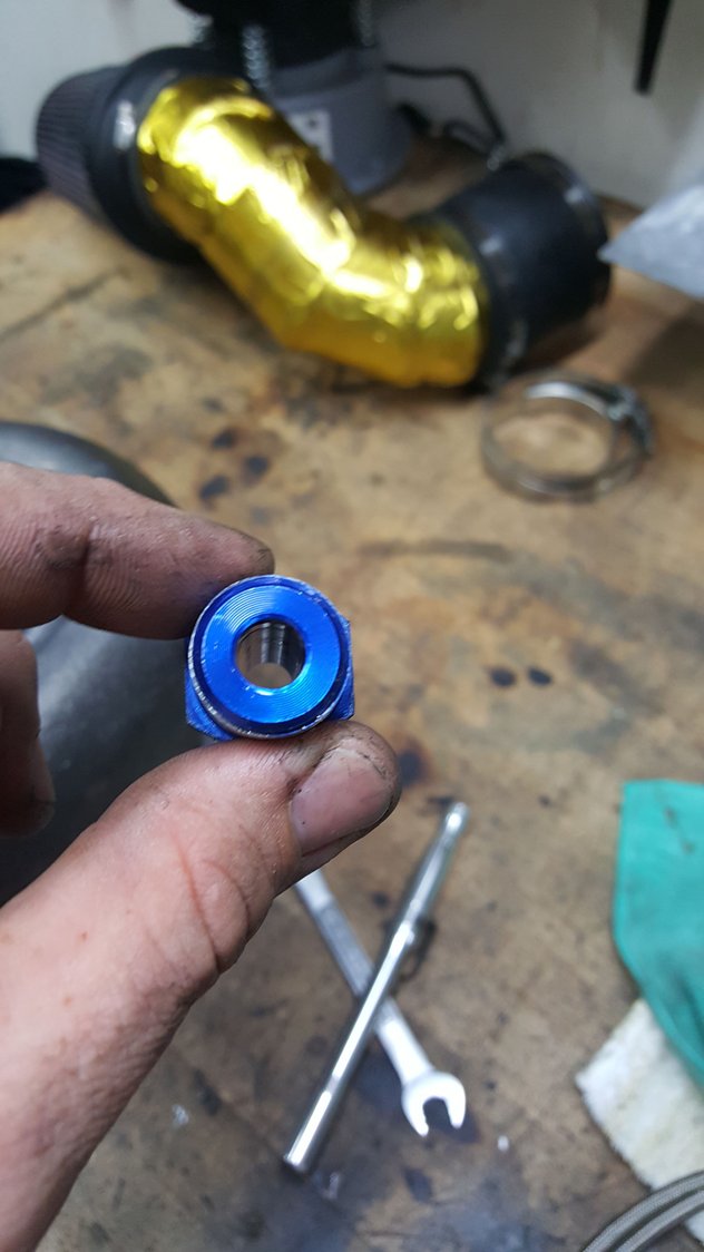

I recently put a turbo kit on my 5.3l. I have a .055 oil feed restrictor and original had the drain to the back of the pan. Started smoking so figured oil was backing up. Moved the drain to the front of the oil pan behind the harmonic and i am still getting oil blow by. I am completely lost, need help. I even swapped turbos thinking that was it. Oil pressure is about 50 or so cruising and 60 wot.

Drain is going straight down the to the front of the oil pan. Im going to check the fitting and see if anything inside is blocking it.

Ok. So I inspected my drain fitting and it was only 9mm. Swapped a different fitting into the pan. And I un hooked my oil catch can. Works perfectly now.

9mm? What size is your drain hose?

I am running -10 braided. The fitting is a -10 but for some reason had a small hole.

That fitting is way to small.
