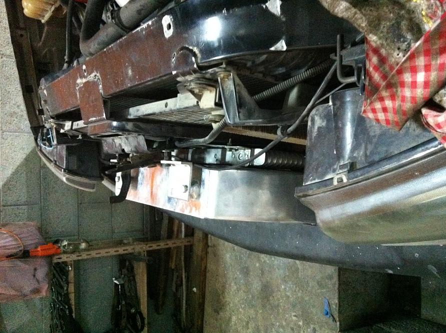

So far, monted the IC and connected cold pipes upto TB. Also connected the cross over pipe but will have to take it out to resolve the issue of the WG hitting the transmission oil pan. It's stock transmission with stock oil pan.
Either will cut the flange shorter to mount the WG in same place or will cut and relocated the flange somewhere.
Will add pics later.

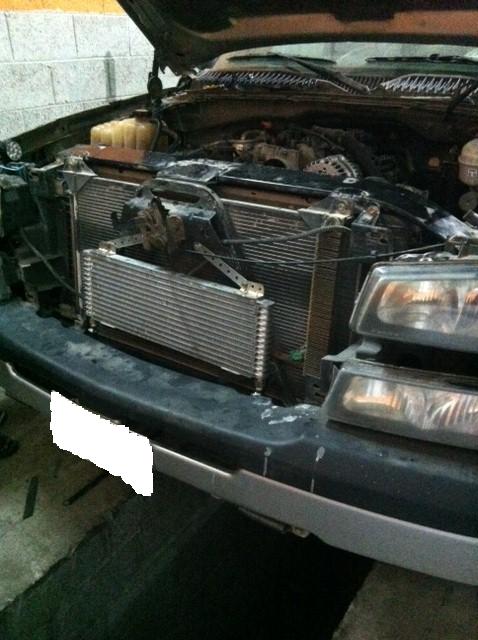

I have another concern which is placing tru-cool 40K Trans oil cooler behind the IC. Is it going to cause overheating of Trans?
Isn't Trans oil cooler in front of the IC going to lower IC efficiency and blow hot air at the IC??
Should I keep it this way and run it or relocate the oil cooler to the front of the IC?

I prefer the tran cooler up front. It's smaller and more important to keep it as cool as possible. The intercooler is so large that little coverage will not effect it's overall performance.
Different layout but this shows what I'm talking about.

The issue is that tru-cool trans cooler is kinda larger and will almost cover the whole front of the IC. See below.

I would still put in front.

I went through the same thing and what I did was put the cooler behind the ic and as far up as possible. The top of the cooler is against the bottom of the support and half the cooler is above the top of the ic.
My trans is 90-100 degrees so far. That's routed through the rad still and it's winter here in buffalo. When summer hits I'll skip the rad.
When I do this I'm going to make new brackets and pull the ic out away from the support bracket another 1.5 to 2 inches just allowing more flow in there. Check my update to the tru cool thread.
If u really want a fan one. U can mount it anywhere u want. Even in the back of the truck under neath. Doesn't need to be in the front. Find the place where u wanna mount it and measure the l and w. Buy the biggest cooler w fan u can fit in there. B and m is nice and I used them in my car.
