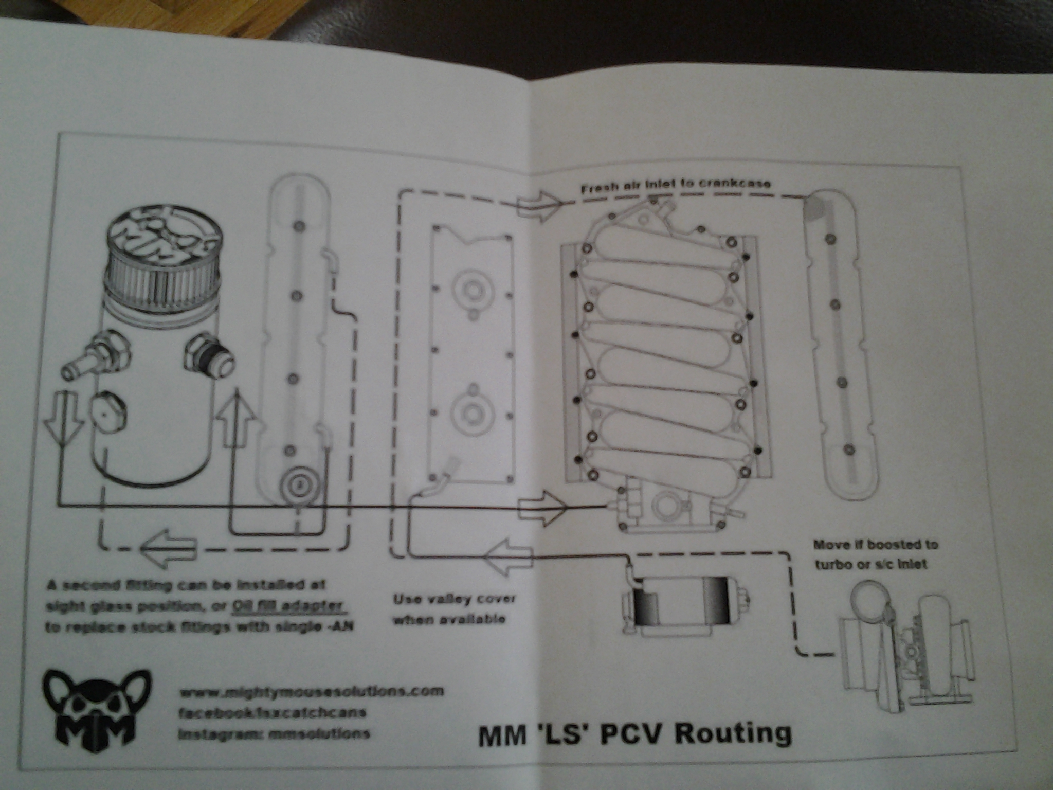

I just got my mighty mouse catch can and want to make sure I hook it up correctly. I have 2 connections on the can one with a one way check valve i was thinking this should go in between the air filter and compressor housing. Then T both valve covers together and connect them to the other fitting. Then cap the vaccum port on the manifold. Does this sound right. Its a vented PCV can.

My poor dyslexic mind. Now i am thinking fresh air from between filter and compressor housing to drivers valve cover. Passenger valve cover to non check valve fitting. Check valve fitting to vaccum source at manifold. Pic of directions

Posts: 4,466
Likes: 62
From: Wichita Falls Tx.
Give them a call or email.
Ask how they want that hooked up.
How's the truck running?
Will do I just sent him an email. Truck is running good still have not done any WOT runs yet but getting into boost quite a bit. I dont think 5# is going to be enough for me. Once BBP finishes the tune I will probably run it for a few thousand miles then work my way up to 10#.
