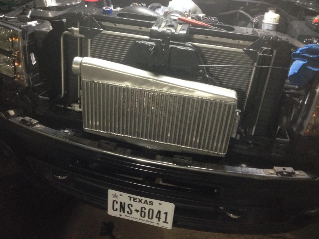

its not really a thick intercooler so I imagine it would fit your body style pretty easy especially since they fit the thicker core intercoolers. I know mine is a nnbs but heres it mounted up on my truck to get more or less a visual reference since our radiators are the same size.

Awesome, I thought that was the intercooler you were running but couldn't remember. How were your IATs with our wonderful Texas weather? I know a lot of guys get by with much cheaper coolers but I don't mind paying a little more for something that's really going to keep the temps down.
