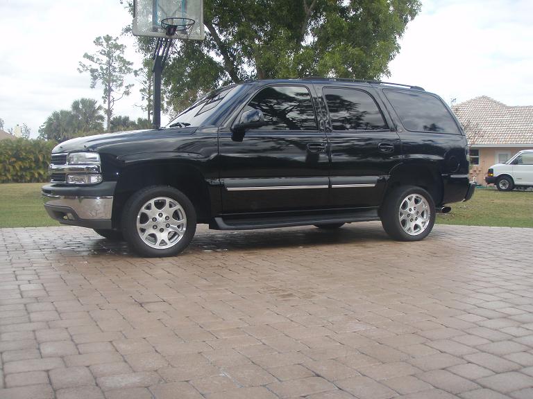

Is it all installed yet.... Results? I am getting a converter installed soon and I have heard that nothing needs to be done to the computer is that correct? My tire difference hoping to drop .5 sec 31" 22r to a 25.5" 17r...... ugly but gets the job done. ha
Attached Thumbnails Track times and tires...-pure-fly.jpg   Track times and tires...-dragradial-1-.jpg
