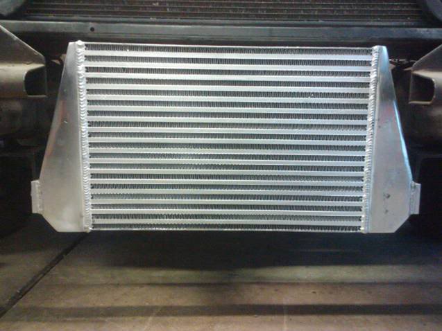

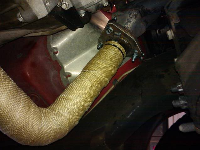

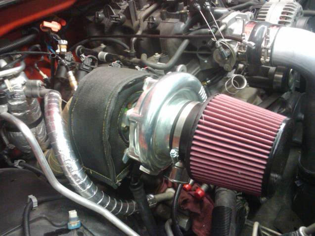

Got the cold pipes lined up, will have to extend one at the intercooler, new TR6 plugs gaped at .035, new Taylor wires with black Thermo-tec heat shield boots, intercooler mounted and leveled, front bumper installed and trimmed and also got the "4 corner" steam port conversion finished! Started on the gauges, its getting a cobalt wideband, electric fuel pressure and manual boost gauges! We do plan on running a AFE cold air box in the corner with a 90 degree bend connecting it to the turbo, just doesn't look right with the filter directly on the turbo?
