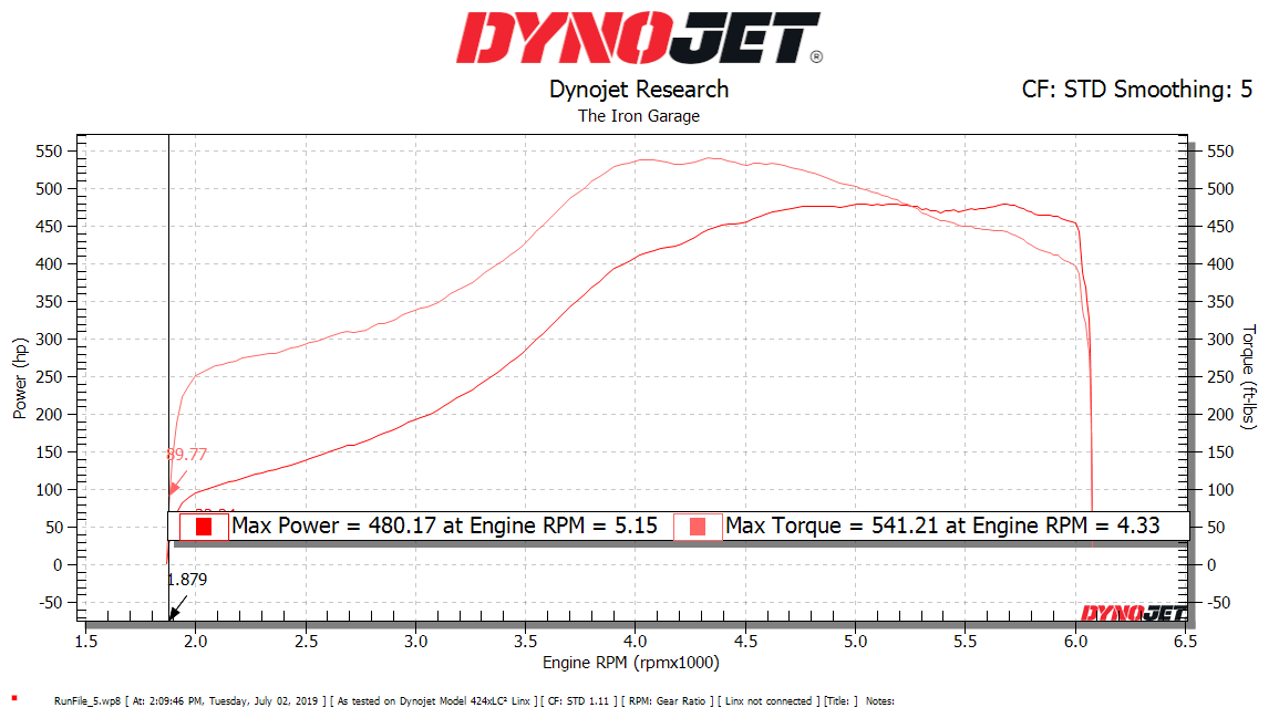

Motor is a bone stock 4.8 lol. Just doing small changes to see what differences they make.
So right now truck is bone stock everything with a turbo and fuel upgrade. Next mod will be converter and trans.

Truck is a 2003 4.8 with 4l60e. Turbo truck that makes 480whp and 540ftlbs. Don’t doesn’t make much below 3000rpm
Best plan on an 80e swap too. That 60 ain't gonna last...😁
