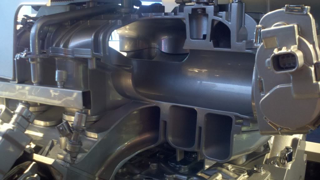

This cutaway image shows that the TBSS runners must be 14-16" long, where the fabricated manifold must have 3" long runners. One manifold is designed to give a torque boost in the rpm range that the engine was intended to be used, the other manifold was designed to look cool.

Those runners are very short compared to any OEM EFI manifold, indicating they would only be helpful at rpm higher than you will ever rev a street motor. Long runners are engineered to boost ram air flow at low rpm because of tuned length resonance. Short runners are for high rpm.
I agree with with it being a "looks cool only" product, but I was not taking into consideration the total length runner size of the TBSS manifold. I was speaking of the height, but yes they are indeed short runners.
