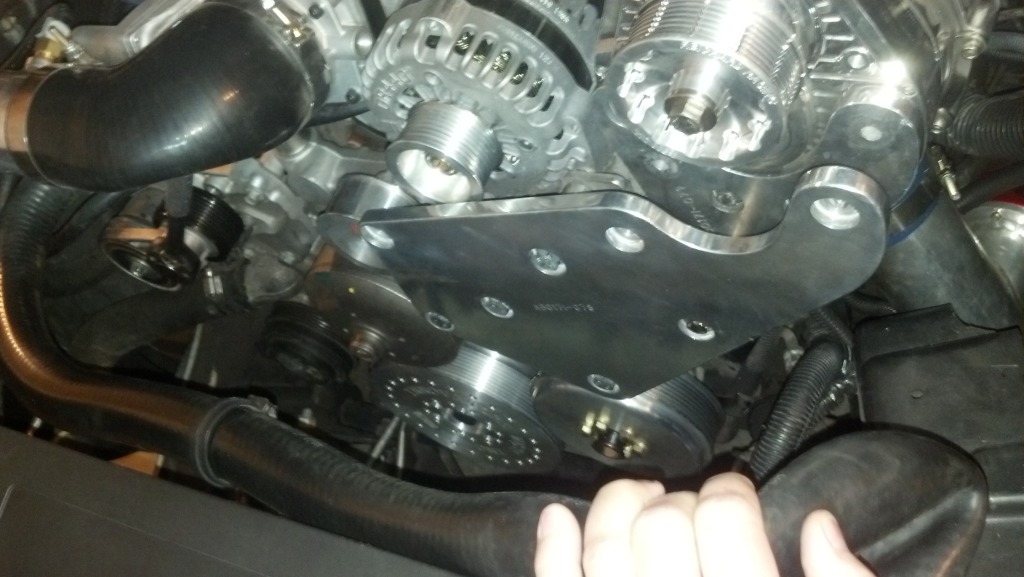

couple updates ... 8 rib set up is on. i ended up getting a innovator west kit , so far im very happy with it seems to be a good quality kit. couple of lil problems i have ran it to thou is its wasn't aligned very well with the procharger stuff so i had to make a couple changes and also had to space the procharger brackets about an 1/8 of an inch to get it all aligned . i also ordered a 100mm idler to put in b4 the blower pulley hopefully i can make it work.

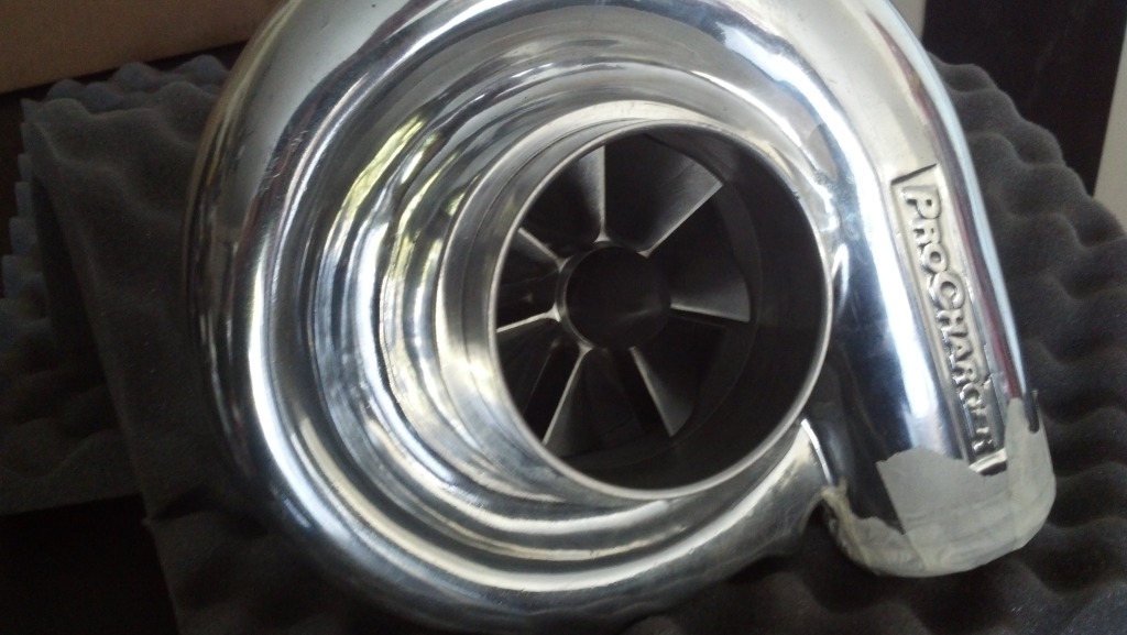

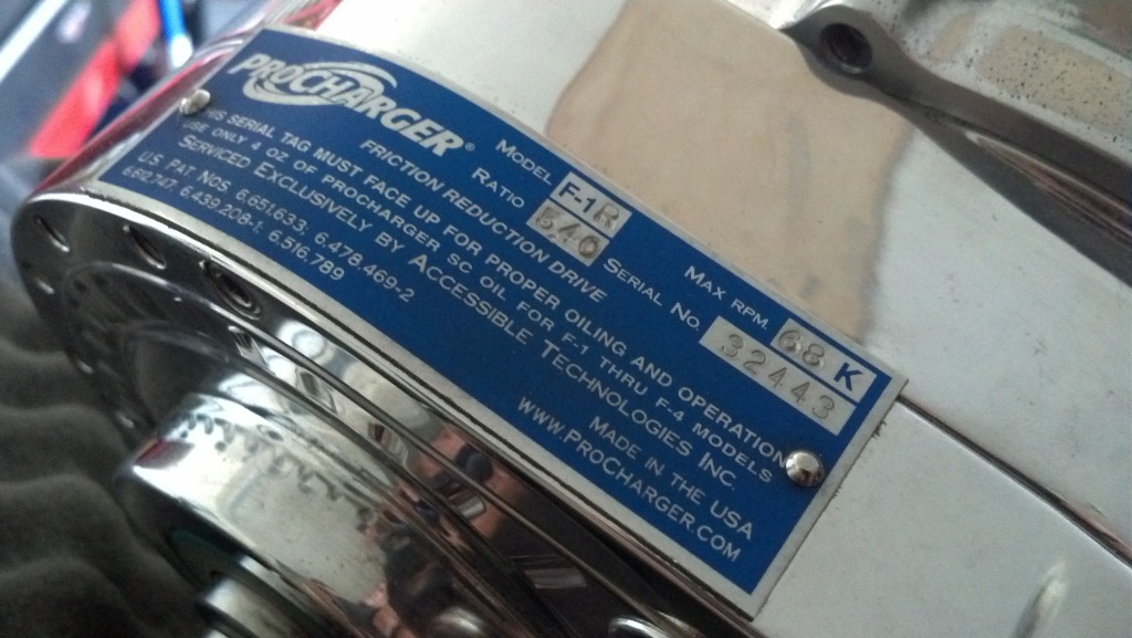

this arrived yesterday ...

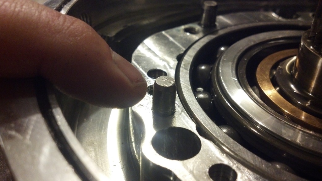

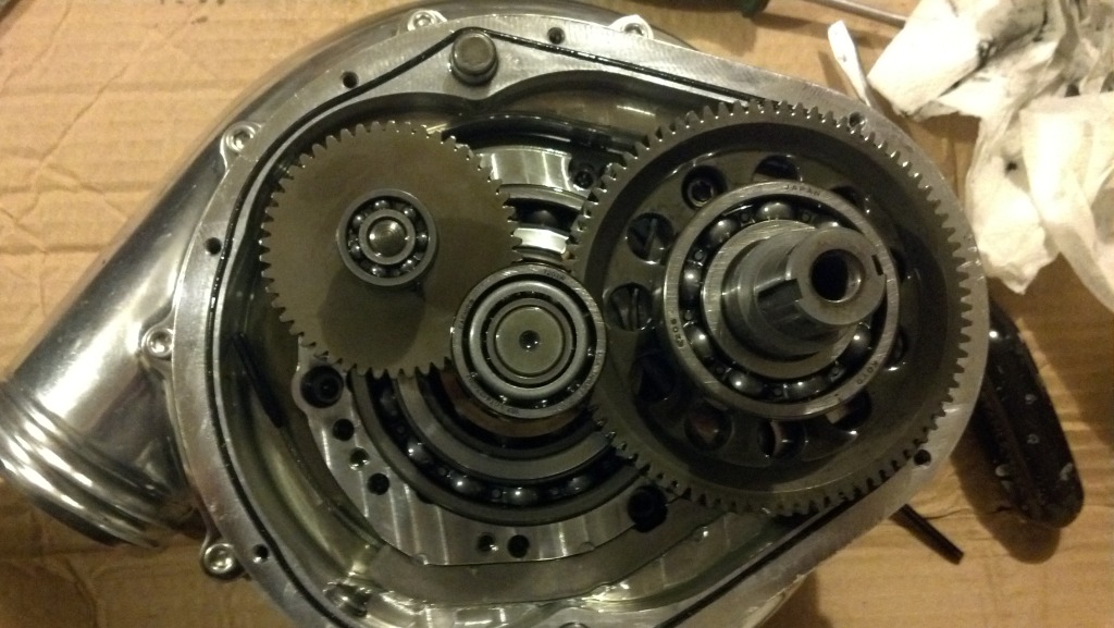

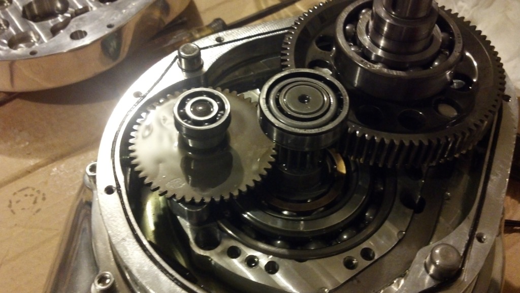

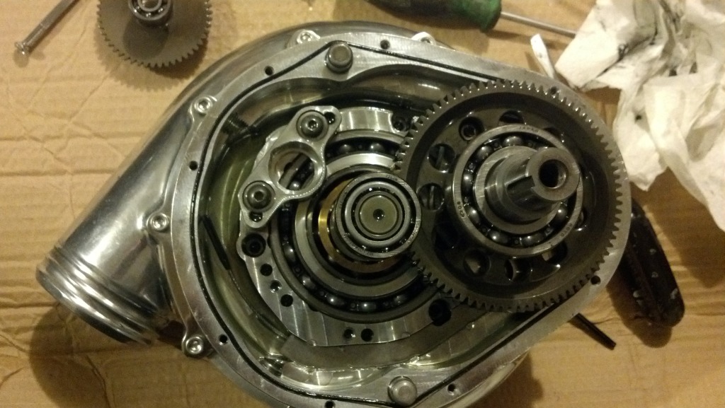

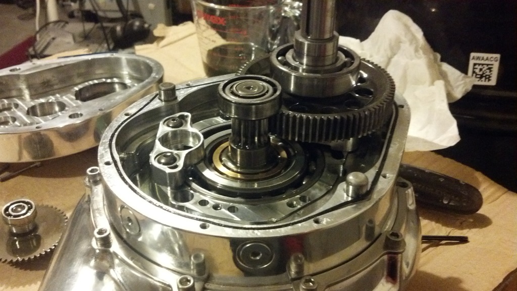

i had to reclock the housing which was easy , then i moved on to reclocking the oil slinger which was easy till i ran into the studs you have to remove going to see if i can find a dowel pin remover after work and it should be smooth sailing from there....
dowel pin thats a sob....

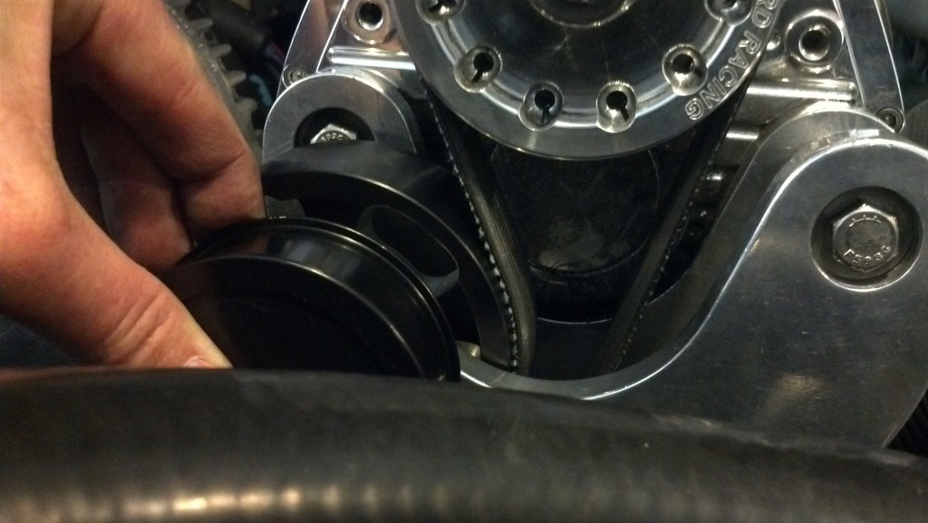

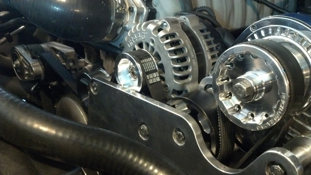

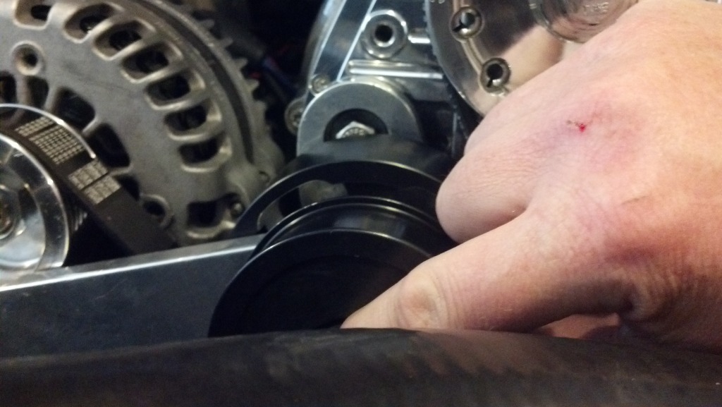

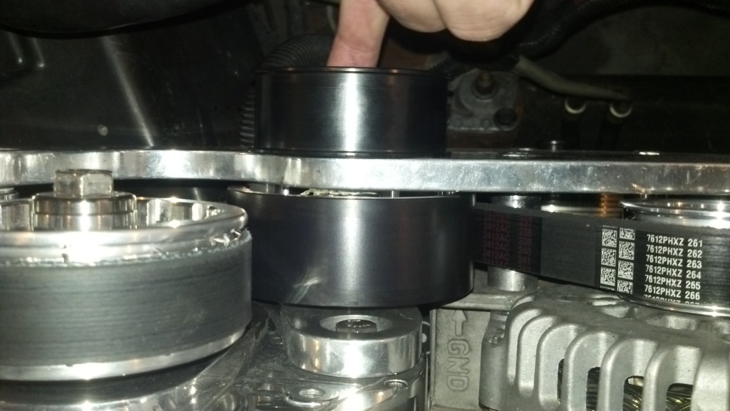

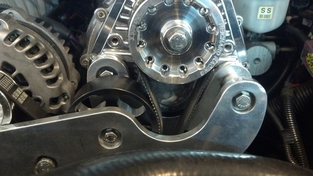

Got a 100mm idler in the mail and managed to make it work. Gave the pulley allot of extra belt wrap and looks great. Please excuse the 7 rib belt i lost a rib during the r&d lol
stock idler next to the 100 mm...

Lookin good anxious to see how much boost that thing makes with that baby pulley on it lol!! I like that idler pulley too think I need to get me one of them. Which one is that?
well that is the d1 on there right now with the 3.5, and i think im going to go do a couple pulls tonight with the 10% od now and see what she does. i want to make sure all of the pullies are aligned and the bugs worked out b4 the f1 bolts on. its a lfp idler pulley 100mm they do make 90mm also. i ordered a 90mm also its actually cool cause depending on what one you have on you can determine how long your belt is and pull slack out if need be.
