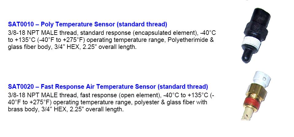

Originally Posted by MikeGyver
I know this has been discussed, but I can't find a definite answer: Does anybody know if there is a threaded, instead of push-in, IAT sensor available? I promise I'll write it down this time.
Sure we get them FJO.
SAT0010 $14.75 standard responce time,
SAT0020 $19.00 quick responce time.
The difference is the quick one sensor is uncovered, no black plastic gooo over it.
we can also get the harness plug for them.
Old Apr 11, 2007 | 10:54 PM
Whippled 496's Avatar
Posts: 2,143
From: Lake Shore, MD
bottom one in that pic is the same one I have.....works great.

Summit has them too pn MSD-2320
Comes with pig tail too

I just go to the parts store and get one for a mid 80's gm car. Worked fine for me. I think it has 3/8" pipe threads.
