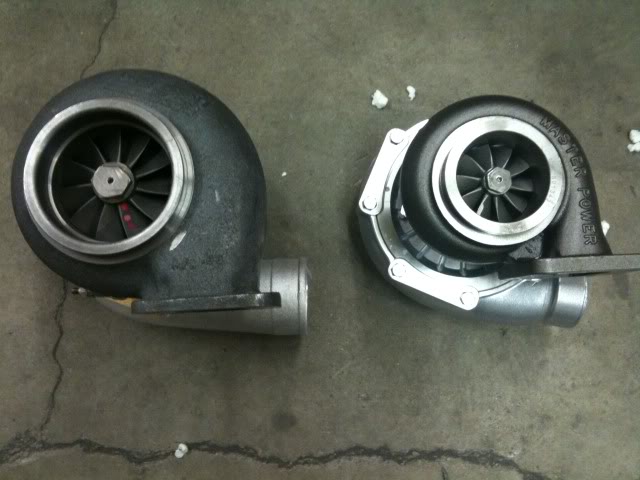

You think a 1.10 AR would be big enough to not cause too much back pressure?
A T6 1.10 a/r housing is HUGE when compared to most T4's like Magnums with there little 67mm turbine wheels. You need to know that a/r is not actually a size, but a ratio of area/radius. With a big turbine wheel like an 83mm of the 75/83 (s475) 80/83 (S480) you have a much bigger area (t6 opening (area) and the 83mm turbine wheel (radius)) so it flows a LOT of air. Here is an example of size difference. Both turbos are T4, .96 a/r, the the turbo on the left is a 94mm turbine wheel (PT88) and the right is only a 67mm turbine wheel (Magnum T76) both .96 a/r's. See the difference?

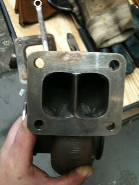

What would be the reason for using a divided turbo on an undivided T4 flange header system? To me it seems like the divider would only cause a restriction but their seems to be way more divided than undivided turbos out there.
Mostly because you can't get an open housing for those turbos. BW doesn't make an open housing. You can knife edge the housing like I did on the T4 1.0 a/r housing I run on my BW 80/83.
