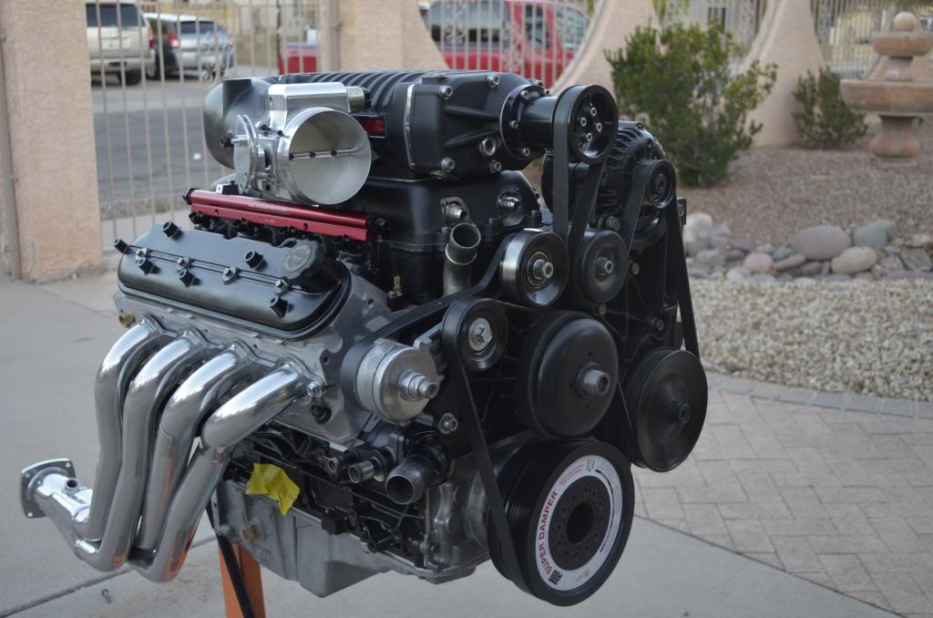

I have a Whipple mounted on a LQ4 with truck accessories. ATI 7% OD Damper and 3.25 pulley.
Looks like my tensioner needs replacement as it appears out of alignment with the rest of my pulleys. Car has not ran yet but getting close...
Do they make an upgrade to this tensioner? (6 rib unit). If so, what part number and where can I purchase? Or should I throw another stocker on there?

Post up a picture of your setup so we can see what you are working with.

It almost looks like a HD tensioner would work on that bracket. Is that a whipple bracket that the idler and tensioner mount to? It looks very close to my Magnacharger bracket.
Yessir..the tensioner mounts to the bracket and it is the one that is supplied with the Whipple kit.
