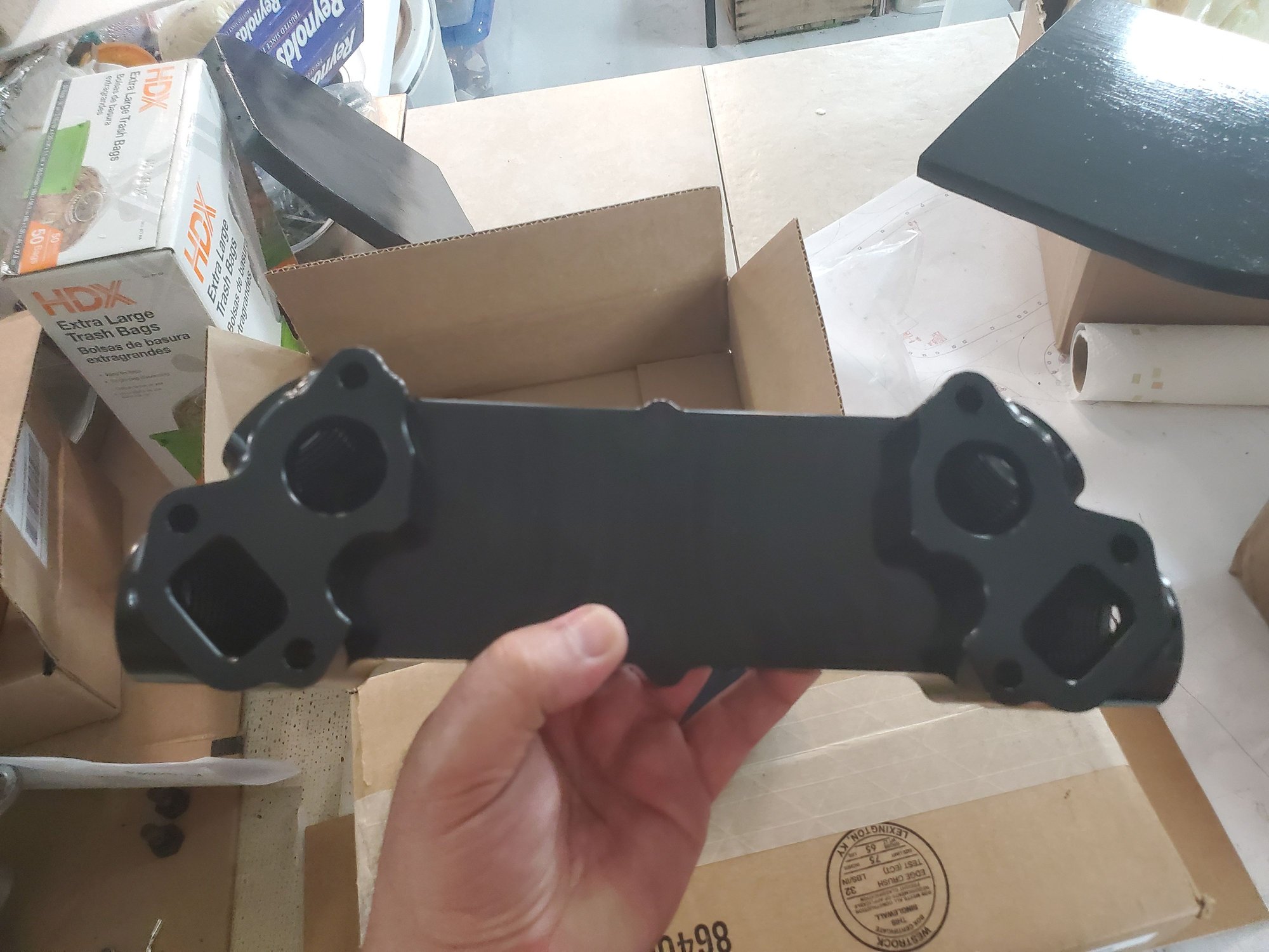

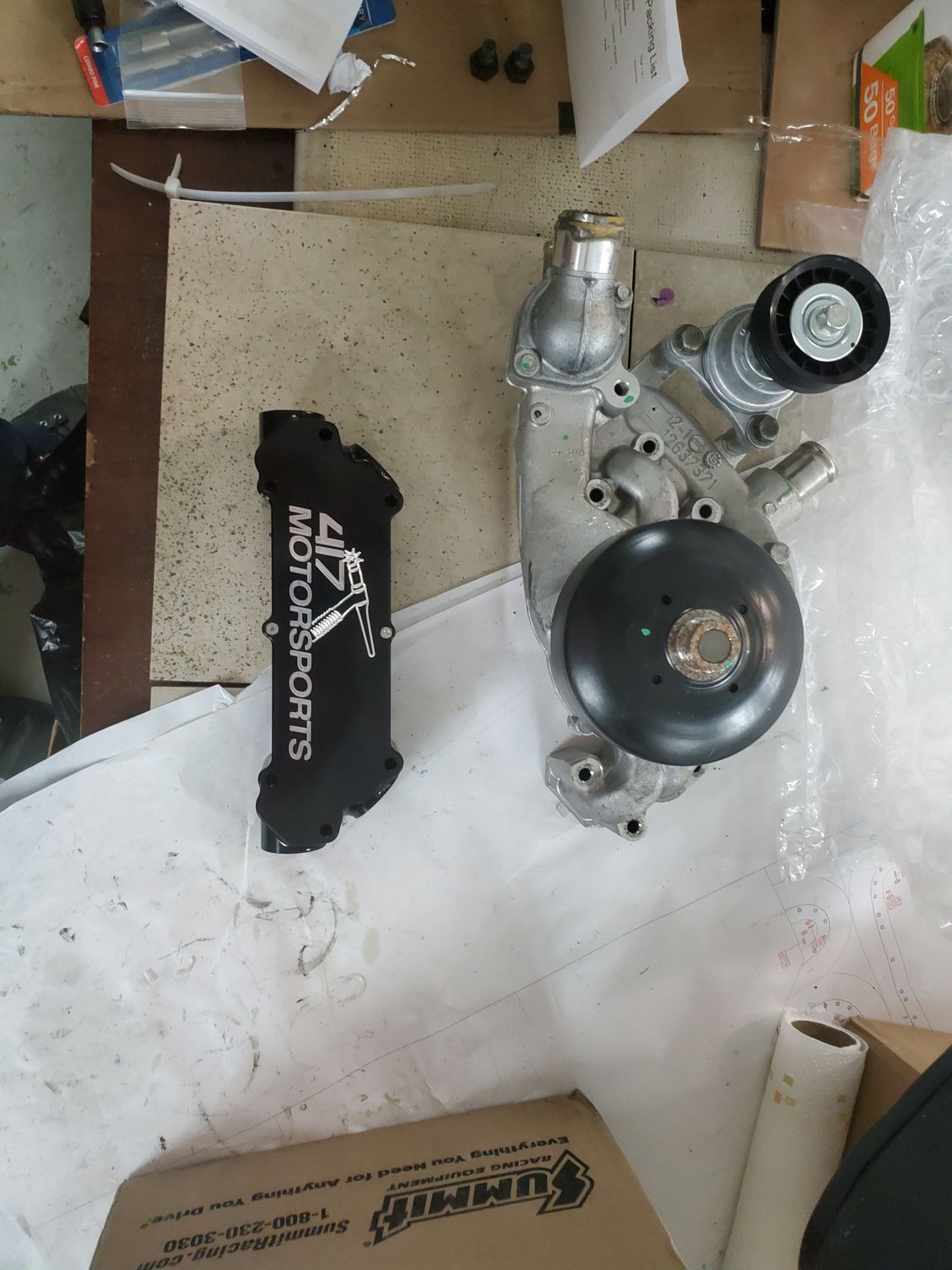

not really, engine still at tms. i had infinitely more fun just boosting the stock engine and pushing it till it blew, this shooting for x horsepower goal sucks
been putzing around a little bit, pulled the entire harness out of the engine bay; some of the loom i used before wasnt high temp i guess melted/flattened out i na few spots. going to lay it all out for the engine on the stand and tape and loom it up nicer, have a few things to shorten up.
still kicking around idea of going electric water pump and power steering- i grabbed a ford/volvo electric steering pump but its about the size of a 2 liter bottle, hard to find a good spot for it. will throw all the old accessories on it for now to make sure junk stays together for a while.
I have the np149 all ready to go in seems a little shorter than the bw4485, front shaft should work fine... the rear driveshaft i may need to get a longer one (back to stock length basically)

no sense in just fixing it without changing/upgrading
