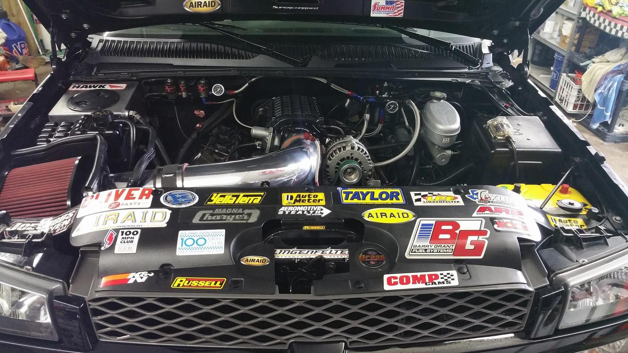

03 silverado SS tvs 2300 truck 10.4 @ 130mph

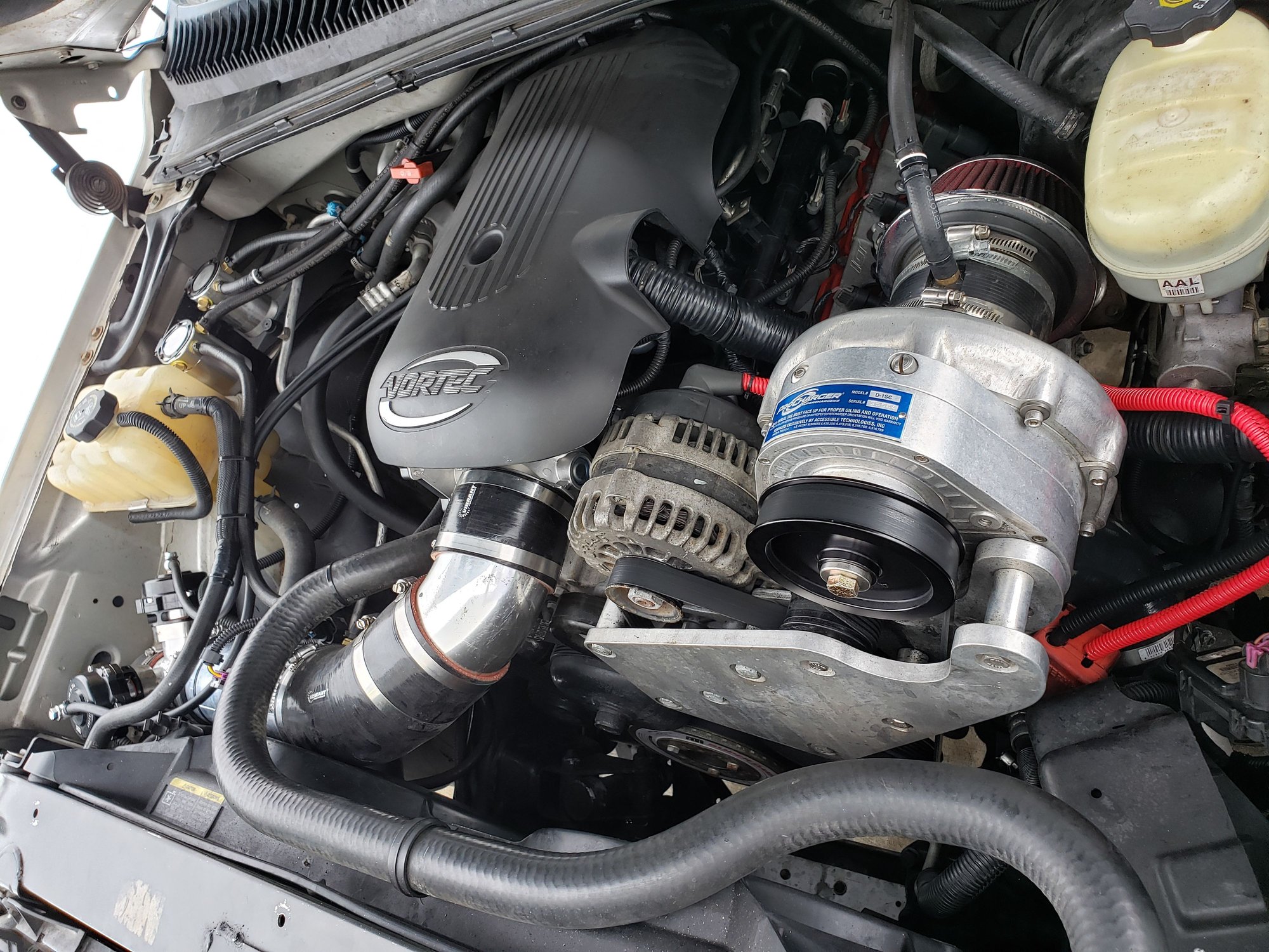

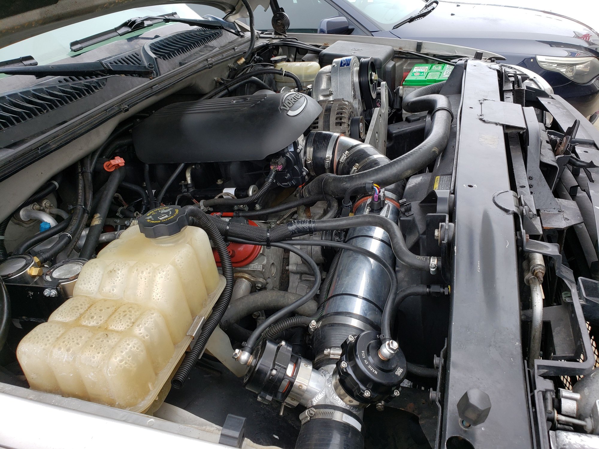

Default Another one
Just finished the build, waiting until the snow and ice stops before cleaning up too much.
408 with forged crank, forged h-beam rods, Diamond forged pistions
Full hand ported 317's with stainless valves from Noland's - they do great work
Cam 226/232 - 588/598
9.5:1 compression
Procharger DS-1 with 4 inch pulley
TCI super streetfighter trans and converter - locks up @ 2,200
Clean and dirty side cans
Up next
New Vibrant couplers
T-clamps to replace screw clams
Meth injector kit
Boost-a-pump or secondary pump in the bucket with return.
TBSS intake and TB
First tune it was putting 407 hp / 444 ft lb to the wheel at 4,300 rpm. Fuel pressure dropped below 56 psi so did not push it any further. Once the pump situation is worked out hoping to put down 600/650. When the meth injectors are added will switch to the 3.25 inch pulley and see what it can do.
Dirty from winter driving..
The wife's twin turbo bratwurster in the background.

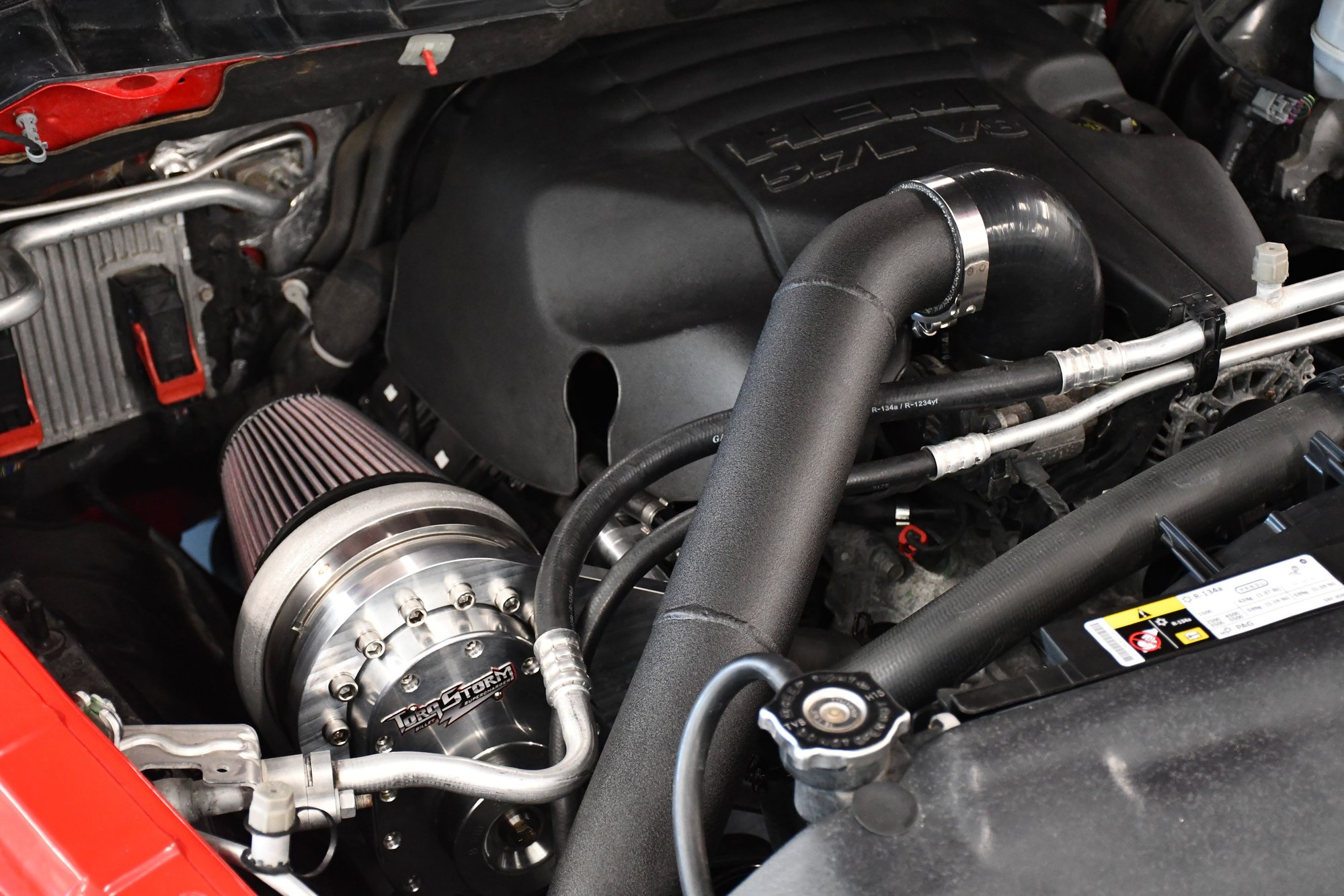

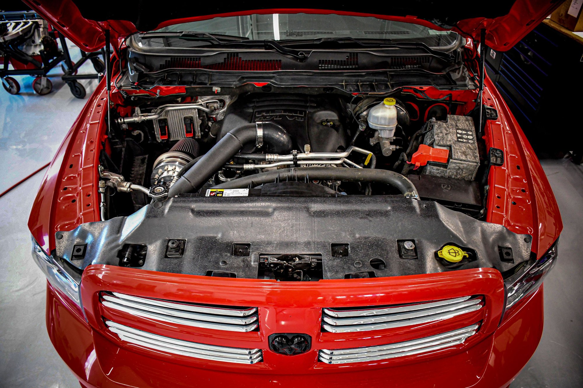

Default Here is the finished Gen 4 Ram Torqstorm Supercharger kit

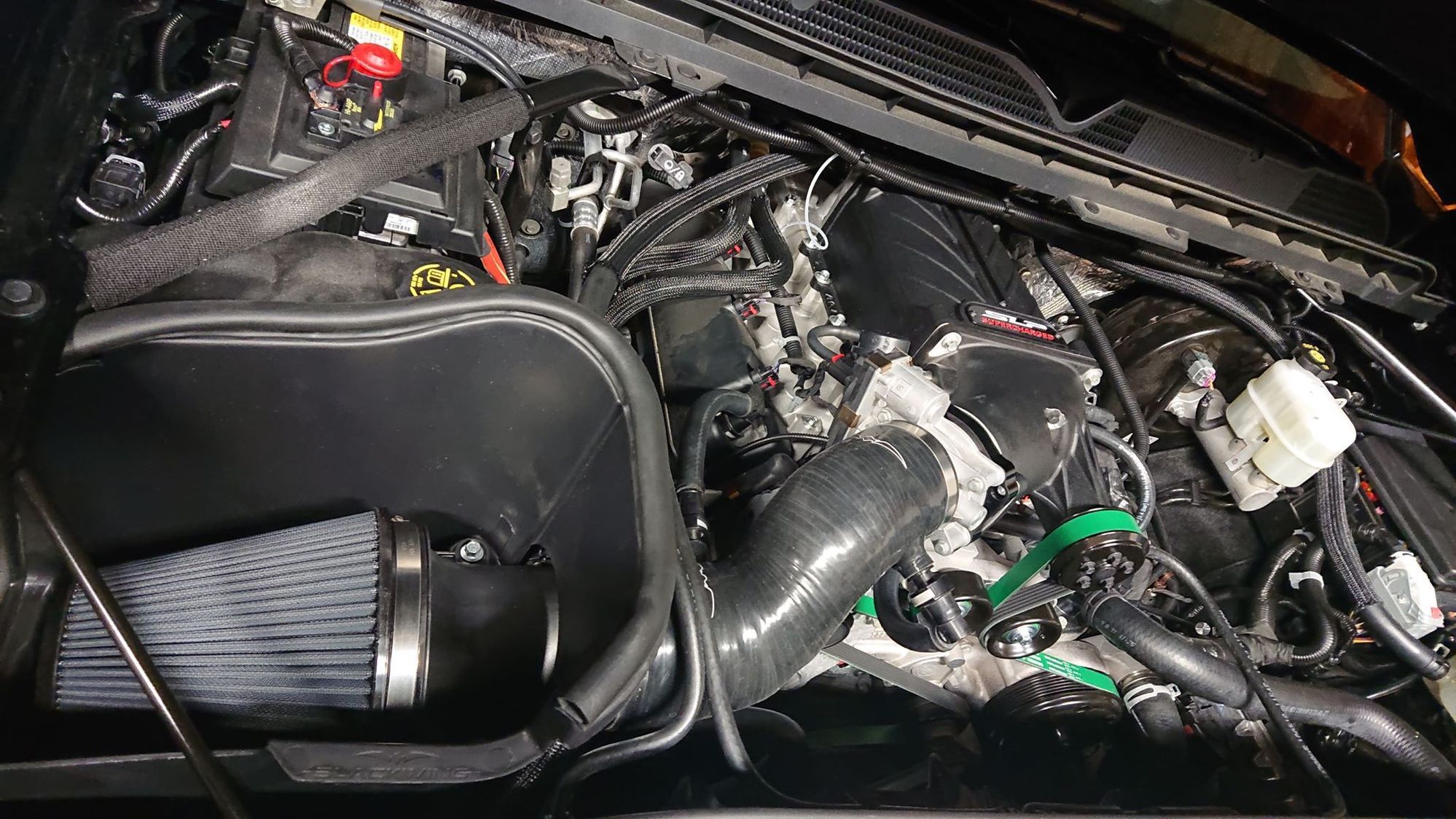

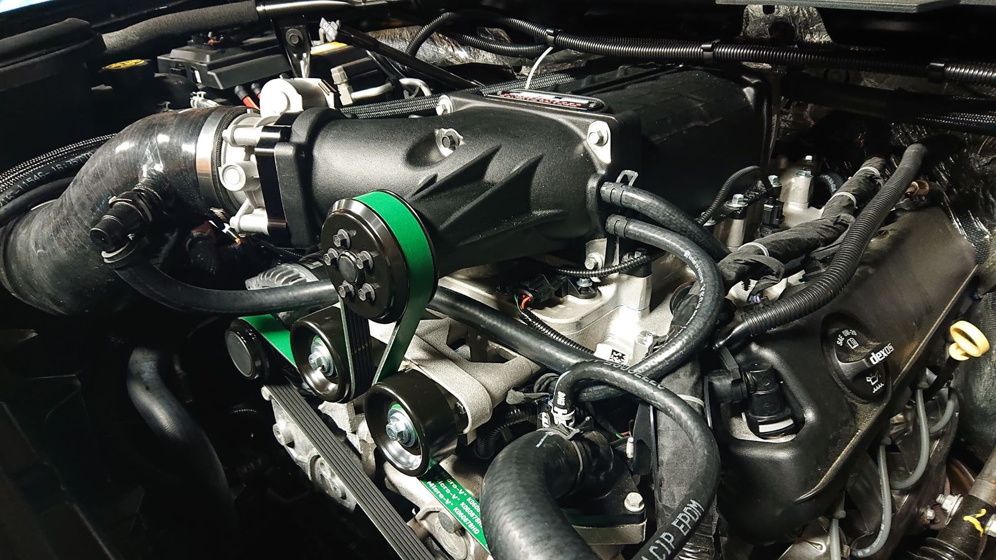

2017 Silverado L83/6L80, 3.42 gears, 6.5" lift, 35" tires
2.9L Whipple

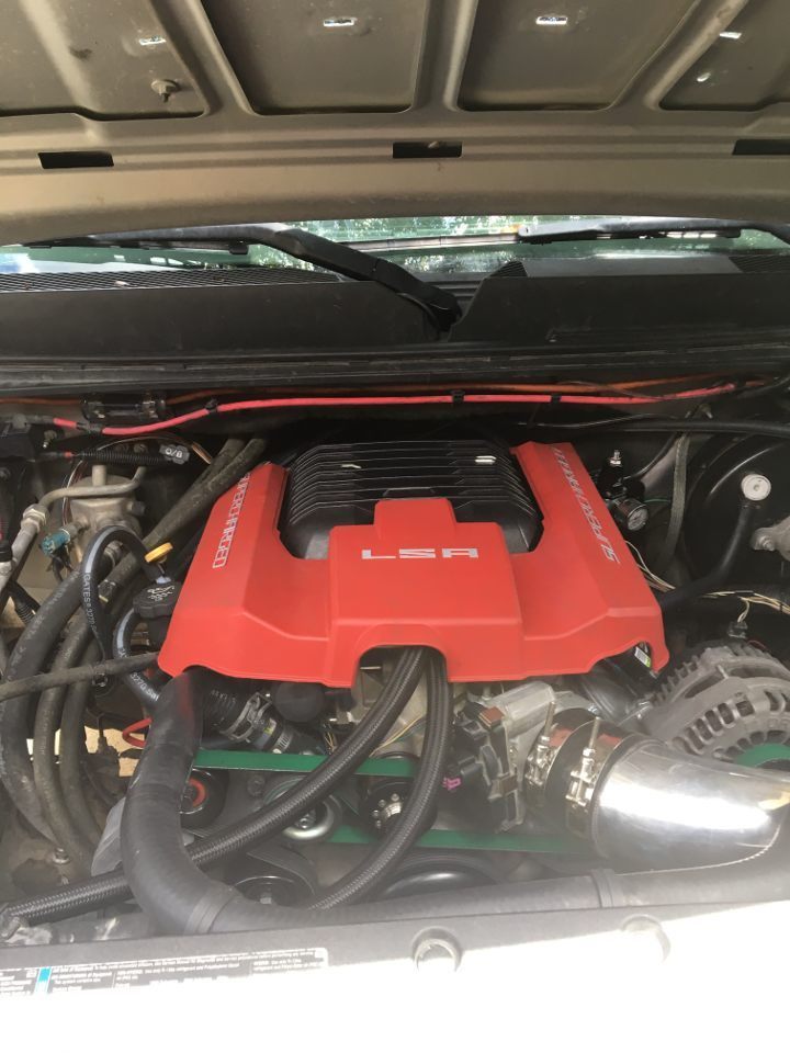

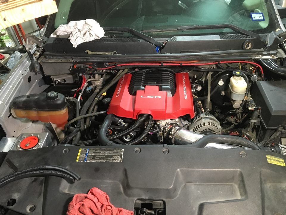

Upgraded to the infamous green belt
