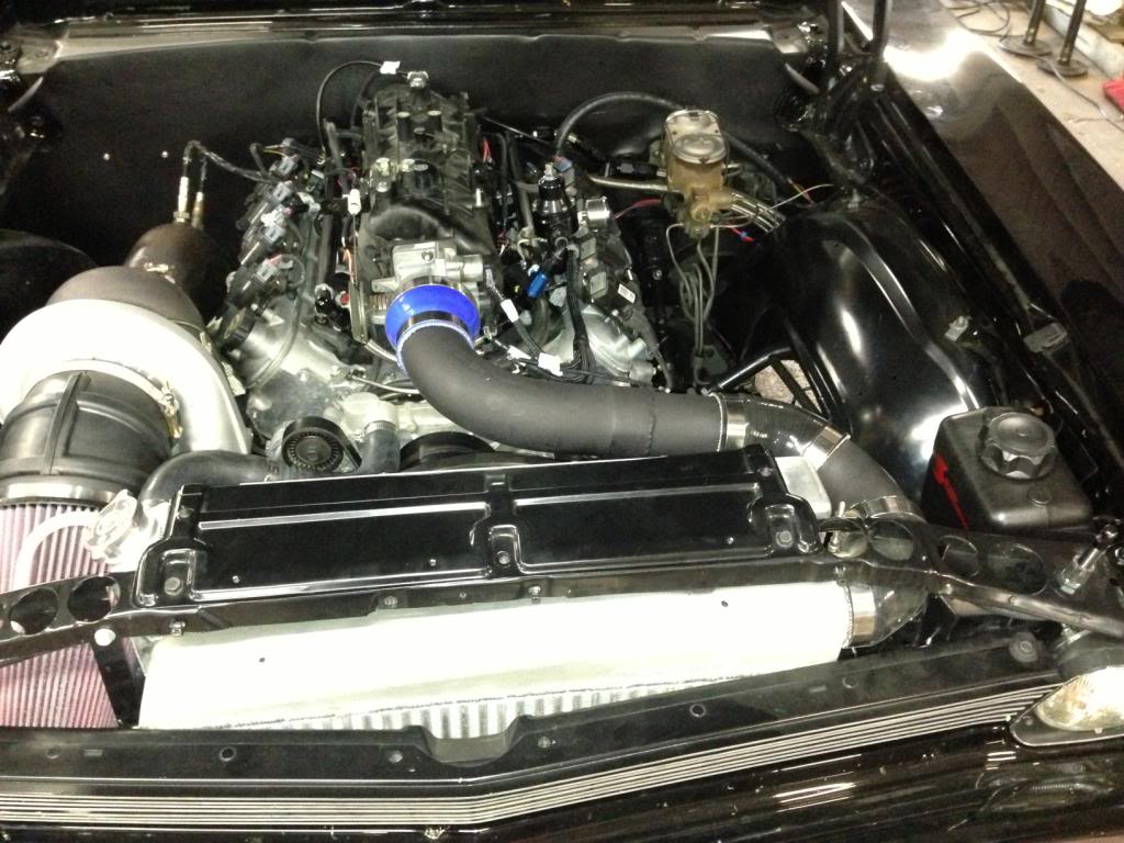

Thanks guy's! Car has my good old stg 2 truck cam lol 218/218, 112 lsa with Isky 165A springs with all factory retainers, locks etc. heads were only milled .008" to take out the warp. Prob ~9.5:1 cr. Jake is right the S480 and billet 76 are right on par except the 76 spools quicker. No plans for any larger turbo right now, this one still has a little more left in it
