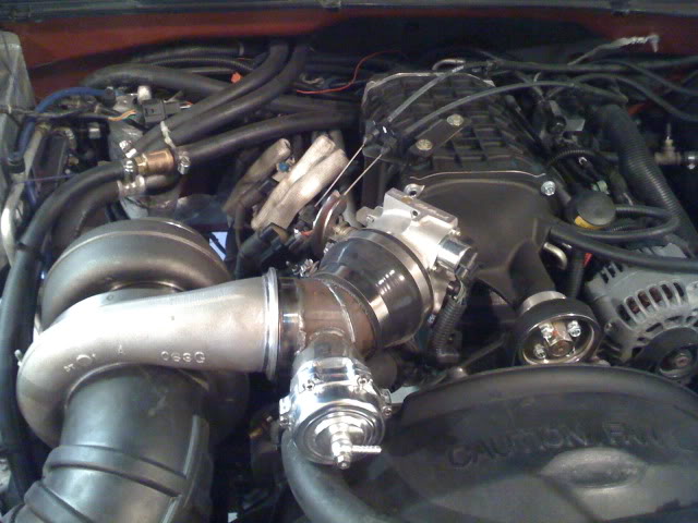

Just leave the blower on and pull the headers off and bolt on a set of hot pipes and force feed the blower with a turbo!! T6 S480 should be able to add 200hp to your setup an still have the instant boost of the blower!
Now that is a setup!
