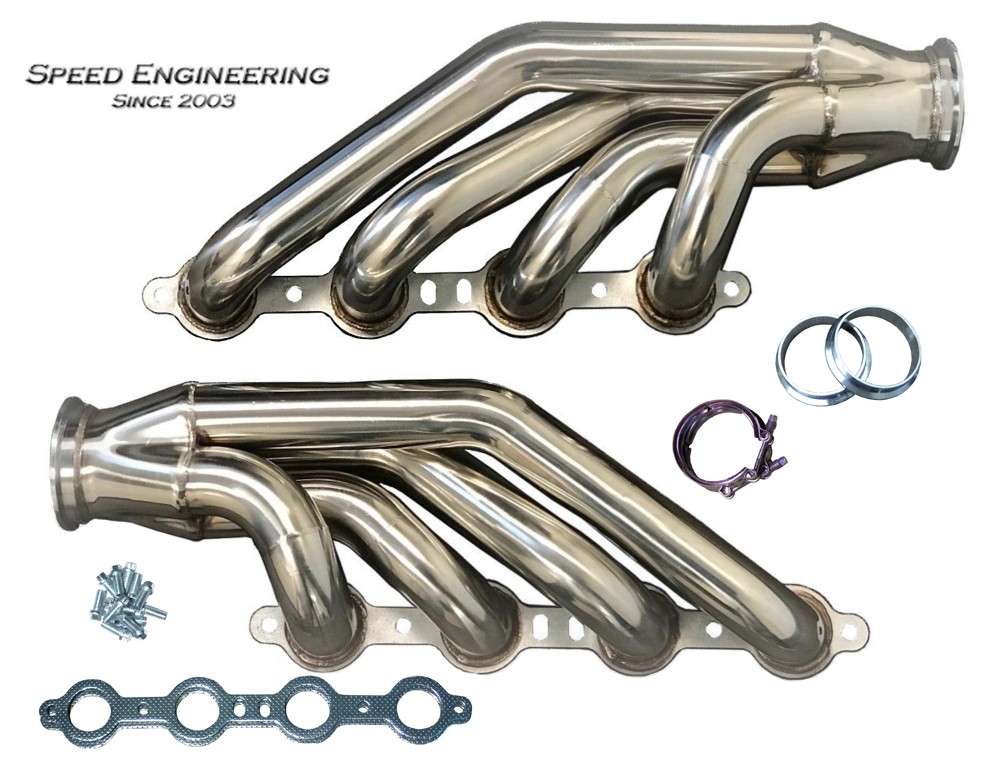

They would have an odd angle inverted because of they way they exit downward. You'd never get something like that under the hood but with enough fab work... yeah I'd say it's doable. Probably look like Cleetus Mac's "Ruby" Corvette with the turbo mounted high like that. A set of Speed Engineering Turbo headers are only $160 and are already V-Band'ed, would be a nicer fitment IMO
