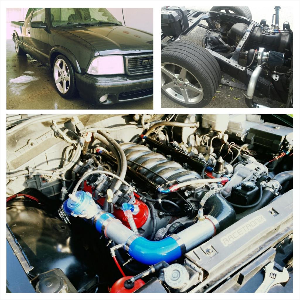

Does it fit at all? We can modify if necessary. I currently have a 5.3 turbo mid mount setup that works awesome but im selling it off and looking to do a front mount T4 turbo setup with my new LS3 and T4 S475.

There is a dude on v8 s series that is running a kb manifold on his blazer. I will be running the Trick Performance log manifold on mine.

How did that trick performance manifold fit on your truck? I read one of your threads, was hoping youd have some pics of it installed.

Well the motor isn't in the truck yet. If you order the kb manifold, definitely post pics on v8 s series. Im curious on clearance issues.

I know it's an old thread but yes the Trick manifold will fit a 2nd gen s10. I'm sure 1st gens do too

Nice pics. The manifold cross over flange could be cut back and rewelded in.
Might have enough room for downpipe to stay inside the frame. 👍🏻

I've built manifolds that are extended to fit an S10. Might be able to squeeze a 3" dp but that would be it. Most guys just go outside the frame rail or fender dump.

this is a gen 1 with a eBay t4 log. Didn’t have any clearance issues with the manifold. Had to run a swap header on the drivers side to clear the steering shaft though.
