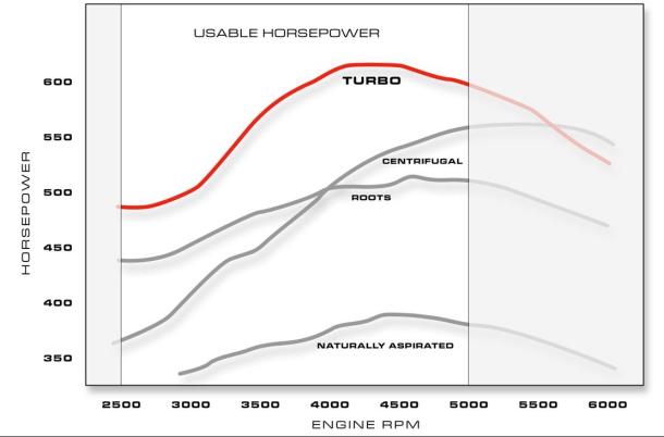

I picked up this info:
This graph appeared in "Battle of the Boost", Hot Rod Magazine in the August 2003 issue. Turbo systems are the clear choice if you are looking to generate usable horsepower between 2500 and 5000 rpm.
"Given equivalent vehicles, the turbo would easily motor away from the centrifugal in an acceleration contest......The turbo offered massive midrange torque production, the only system to exceed 600 lb-ft. Need more convincing? At 4,000 rpm, the turbo was more than 100 lb-ft. stronger than either the Roots or centrifugal." Richard Holdener, "Battle of the Boost"
