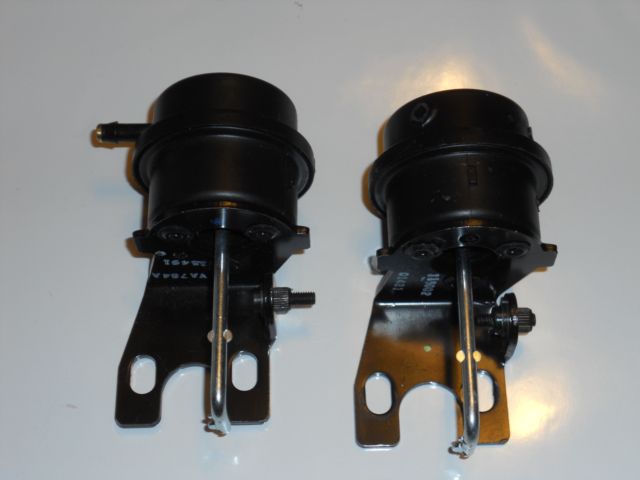

I have found a replacement for the Roush tvs1900 bypass actuator for guys needing them.
I just order this but have been on the phone with them and they measured it out for me. I will post a picture when I get it to confirm that it does fit.
It should be a direct fit. It looks just like the factory one.
I should have it next week around 11-24-2010

Guy I received the bypass actuator and it is just like the Factory. The vacuum inlet is located down just a little but she will work. Hope this help others if they have problems.
GReddy Supercharger Bypass Actuator - Replacement part number
[MPI-VA784A]
Replacement bypass actuator for the GReddy supercharger kit for the 2000-05 Toyota Celica. I think the guy said something about it being for a mp62 Eaton
This is the info just in case we loose the link for the replacement we know what it fits.
Darrin

Good to know Darin, thanks.
I looked at the one on a maggie 2300 and it too looks identicle.

Did yours break?
Old Nov 23, 2010 | 06:14 PM
6.055chevy's Avatar
Joined: Oct 2010
Posts: 55
In shipping just like most of everyone else's did.
(I looked at the one on a maggie 2300 and it too looks identical)
Tim I looked at that one to, but I thought it was shorter at the mount.
Also could not get anyone willing to help, or look at them. You know the DRILL

You have a picture of the bypass on the tvs2300 we can see. I like to see if it's the same.

Good to know.must be an eaton part. Mine is also broke but at where it mounts to the bracket
