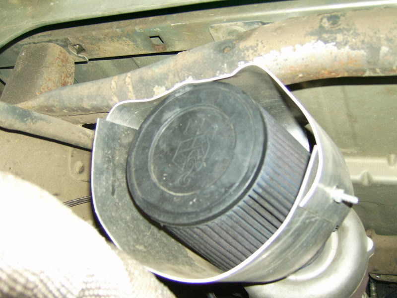

I havent had any problems with my kit.... but i got this lil cool aluminum guard i engineered in about 5 seconds.........
i put a K&N outerwear thing on there after i took the picture....
