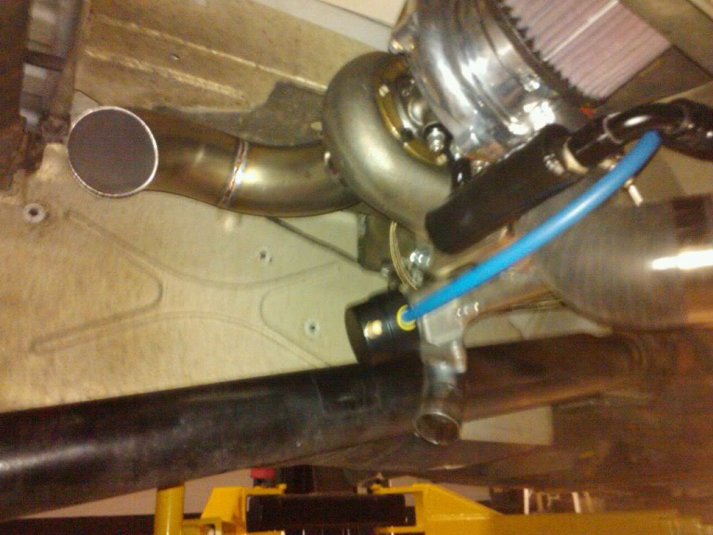

Fairly cheap but must be well thought out. Make sure you run a very good return pump, exa pumps are killer, -10 return lines!, also run a 1 psi cracking check valve on the feed line to keep all of the top end engine oil from running in to the intake/exhaust housing when the vehicle is off and parked un-leveled. Try to keep the return pump lower than the turbos drain outlet and you could make a small reservoir like i did which allows the oil to puddle up and keeps the return pump lubed/primed better.

Vent that resevoir with a 3/8" line and filter and your pump will thank you. No pulling vac anymore making the pump work harder, turning faster with less current draw.

89LS1FOXER- thanks for the pics man
