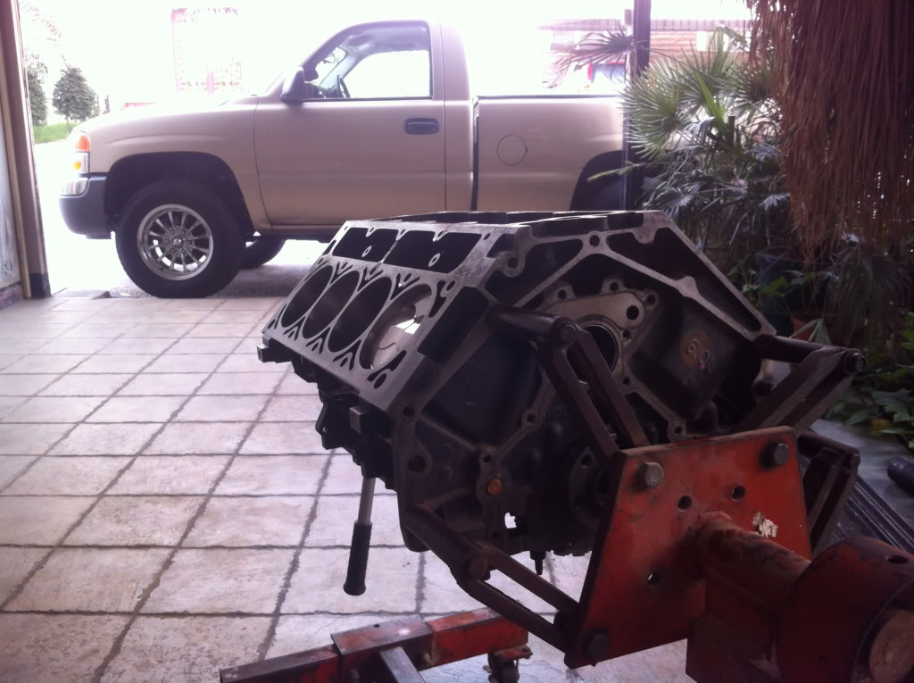

I think if I installed a ported stock exhaust manifold with single 3 inch catback with high flow cats I would see 8 to 9 psi. So my plan is keep what I have now which is long tube headers and duel exhaust no cats see what I get then maybe go back to stock exhaust and magnaflow muffler.. I ported the stock manifold on my other car and lost 1 psi but I saw 12 hp at 4000 rpm increase in hotter weather.
I took block to machine shop to check all cilinders block is fine here is a pic of my monster and 408... I have its brand new original 4.8 that is in there temporarily with the radix I am seeing 17psi I love it I want to blow that up on the last day before 408 install

Nice build. But you will only see about 6-7 psi max with the 112 and the 408. But you will make good power. Do you have a 4l80e yet?

6 or 7 psi is ok I am only looking for low end power
I have the stock trans with hd parts I have overhauled it maybe 8 or 9 times already sux haha... the 4l80 is very big job I will see about it after this motor install if I go threw these transmissions a lot then I will swap it........stand by for 408 video .
