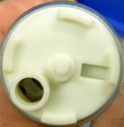

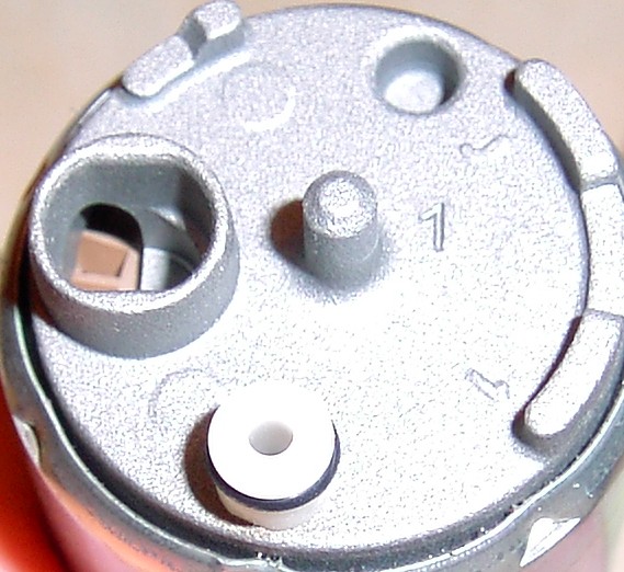

Walbro GSS341 gerotor pump in the 2004 kit. Higher flow rate than stock Bosch turbine pump at a given pressure. Pump is a little taller than the factory Bosch pump. Due to the gerotor design the GSS341 can't incorporate the additional small bottom outlet seen on the Bosch. This outlet is required to drive the venturi intake that scavenges fuel under low fuel conditions. Actual flow rate depends on your operating pressure. If your regulated pressure is greater than the pressure at which the pump was rated, your max fuel flow will be less than advertised. Charts I have seen show the high pressure GSS341 at around 193L/hr(51 gal/hr) at 60 psi(2004 system pressure). There are online calculators that you can use to determine how much power that will support.
Increasing the voltage to the pump over the rated voltage can also increase flow. Though much of this will likely be dumped by the in-tank regulator in a returnless system. A given pump will not support the same level of horsepower in a returnless system vs a return style system.
Attached Thumbnails Radix fuel pump-factory-fuel-pump-002.jpg   Radix fuel pump-walbro-gss341-fuel-pump-061.jpg

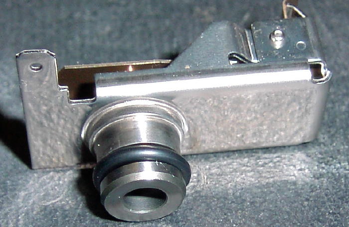

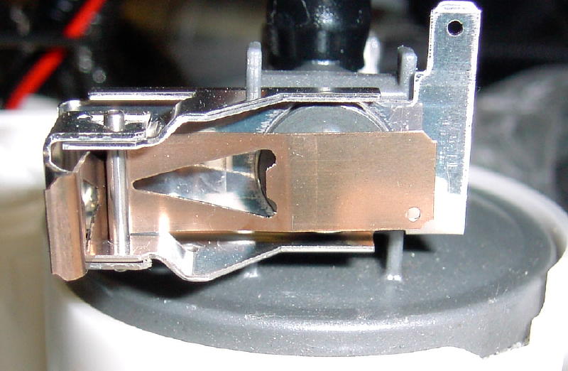

A regulator at the fuel rail would help to correct the line pressure drop seen with the returnless system but that would require some plumbing to run a return line back to the tank. The OEM in-tank regulator would have to be removed and the orifice in the filter blocked off(or just jam/weld/screw the reg closed). I believe that the point of regulation is the main problem with the returnless setup.
Here are some pics of the OEM FPR on and off of the filter. It's a very simple mechanism. The plastic cover/retainer has been removed from the FPR to illustrate how it attaches to the filter.

The OEM fuel module is available only as a unit (bucket with pump, filter, regulator). Individual components are not available separately. You would have to purchase the whole module if you want to replace the filter or regulator. I don't think replacing the OEM FPR with a new one will make any difference.
