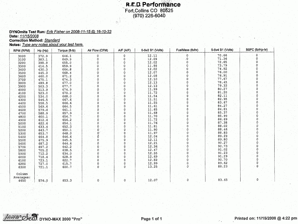

I put a 1900 on a 408 and it works great. Just go with the 112 until you can afford the upgrade. I made 727 hp and 653 ft/lbs at 6 lbs with some trick mods. Here is the dyno chart.
How did you make 727hp with just 6lbs of boost?
