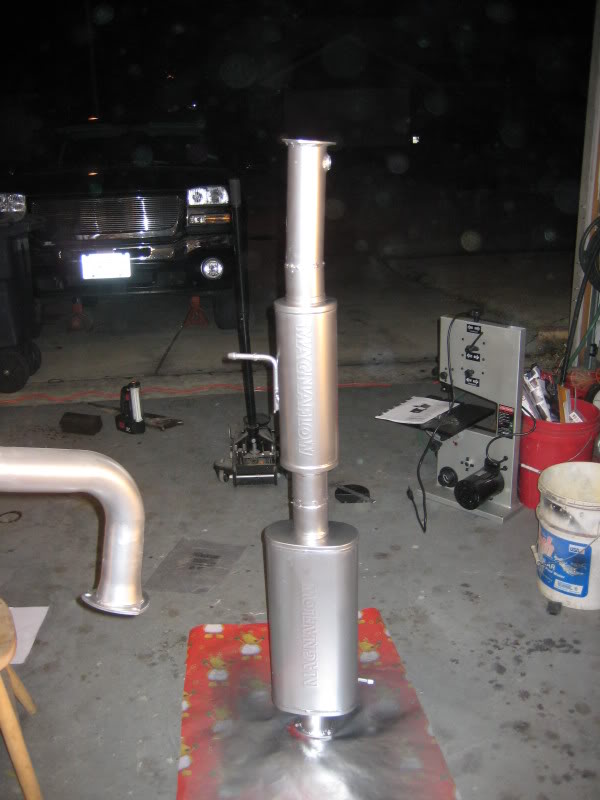

What about stacking to mufflers. Along time ago when i was NA i put 2 mufflers in series. One round and one oval. I think i could fit 1 round and 1 oval like i did before. My 3.5 magnaflow muffler is really quiet but the case on it is HuGe.
Something like this but in 4in is what i am thinking.
