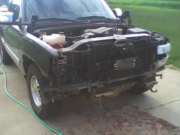

heres a pic of my wrecked truck about a month ago, its fixed now Name:  l_cbebef3eb45748ac92680f58dd2a068c1.jpg
I bent the frame in 3 spots, bent the spindle, control arm, a arm, and alot of other spots

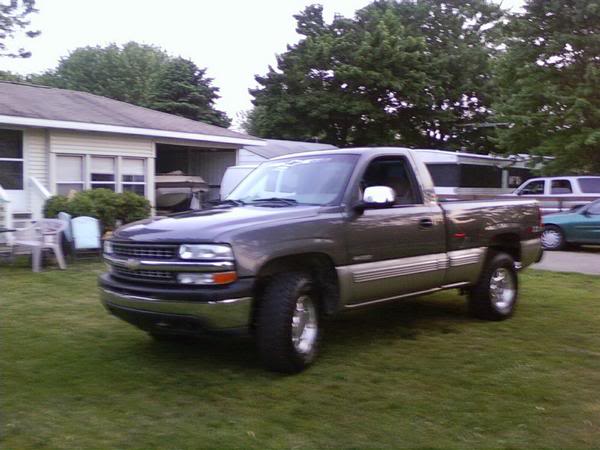

i just got it fixed in this picture and waxed it at my uncles house

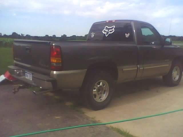

then my back end with duels
