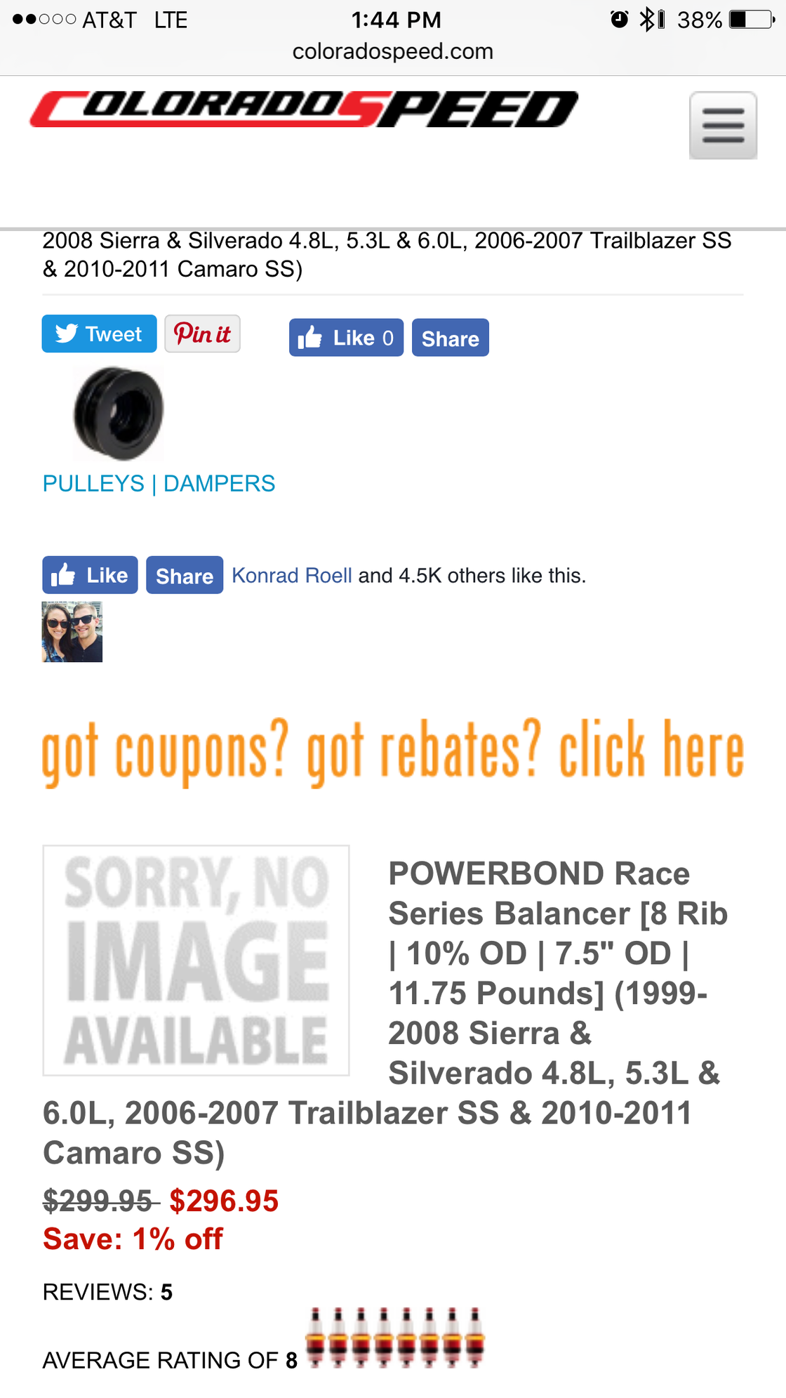

Did find this too. But still would have to change upper to get 10 lbs I believe.
Doing the upper is cheaper.
But I want to reiterate that you are getting hung up on a number that doesnt mean a whole lot. Right now, when your truck is tuned, it will be making more power at a lower boost level than a comparable truck without breathing mods.
If you wanted, you could save money and not re-pulley. You are still making better power.
Pick a whp goal, not a boost level goal. There are 4 cyl motors out there with 22psi in them factory that are getting their *** handed to them by built motors and bigger turbos pushing 18. Its just a number.
