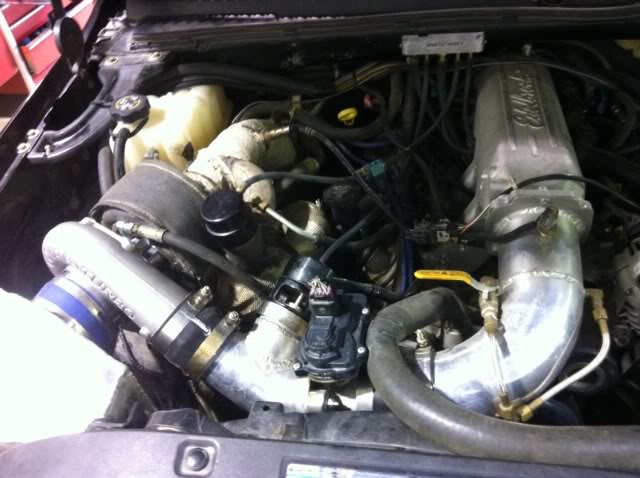

Is that ball valve so you can turn one off your meth nozzles off?

Yes it is. I got the surging fixed, just took the wastegate apart and put two washers under the spring, not sure why it acts so different than the first setup though... Now i just gotta get a meth tank built so i can crank it up!

how does low end feel with the new mani? when out of boost.

it definetly bumped the power curve up but i like it, its smoother to drive and the boost comes on so quick now i dont notice any missing torque

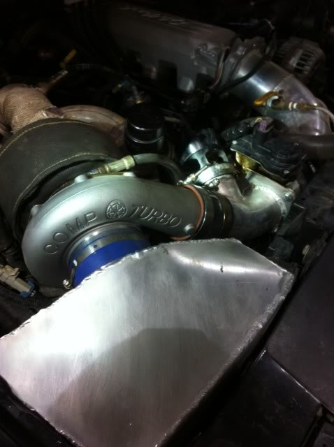

Swapping in comp 7679

Turbo feels pretty good, boost response is actually faster than the old mpt70! It responds quicker but doesn't come in so hard, its very smooth. I only ran it up to 12 psi but it seems to pull harder. I still need to up the downpipe size as its slightly smaller than the turbine exit so i would assume its hurting power pretty bad. Also im back to not being able to keep the BOV shut, i have shims and a way heavier spring than JGS uses so i dont know what the problem is...

I really like that air filter setup!!

thanks, it ended up taking a lot more time than planned but i'm glad i did it, besides the cleaner and colder air they also take way longer to get dirty out in the fresh air as opposed to getting swirl off the tire
