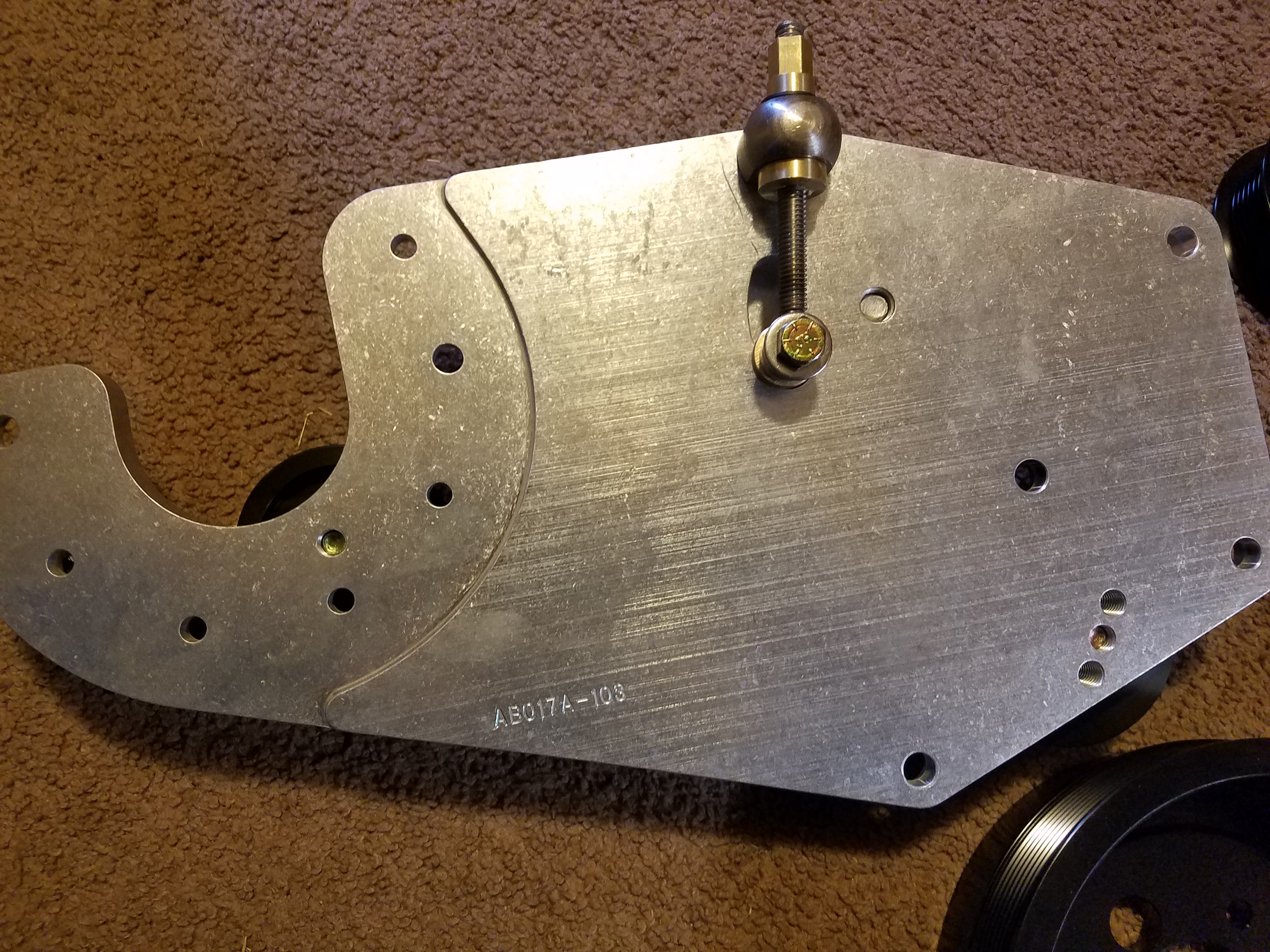

Every thing but the ATI dampner came in, all looks pretty nice. Will be this weekend before I can mess with it, I might start a little install thread when I put it on.
I'm right at 1600 for
the bracket,
ATI balancer
Crank pully
Crank pin kit
3.55 pully
And belt.
As for the ATI balancer vs the "stock modified " 2010 camaro balancer, it's only like $30 more to go with the ATI setup
Here's a little eye candy

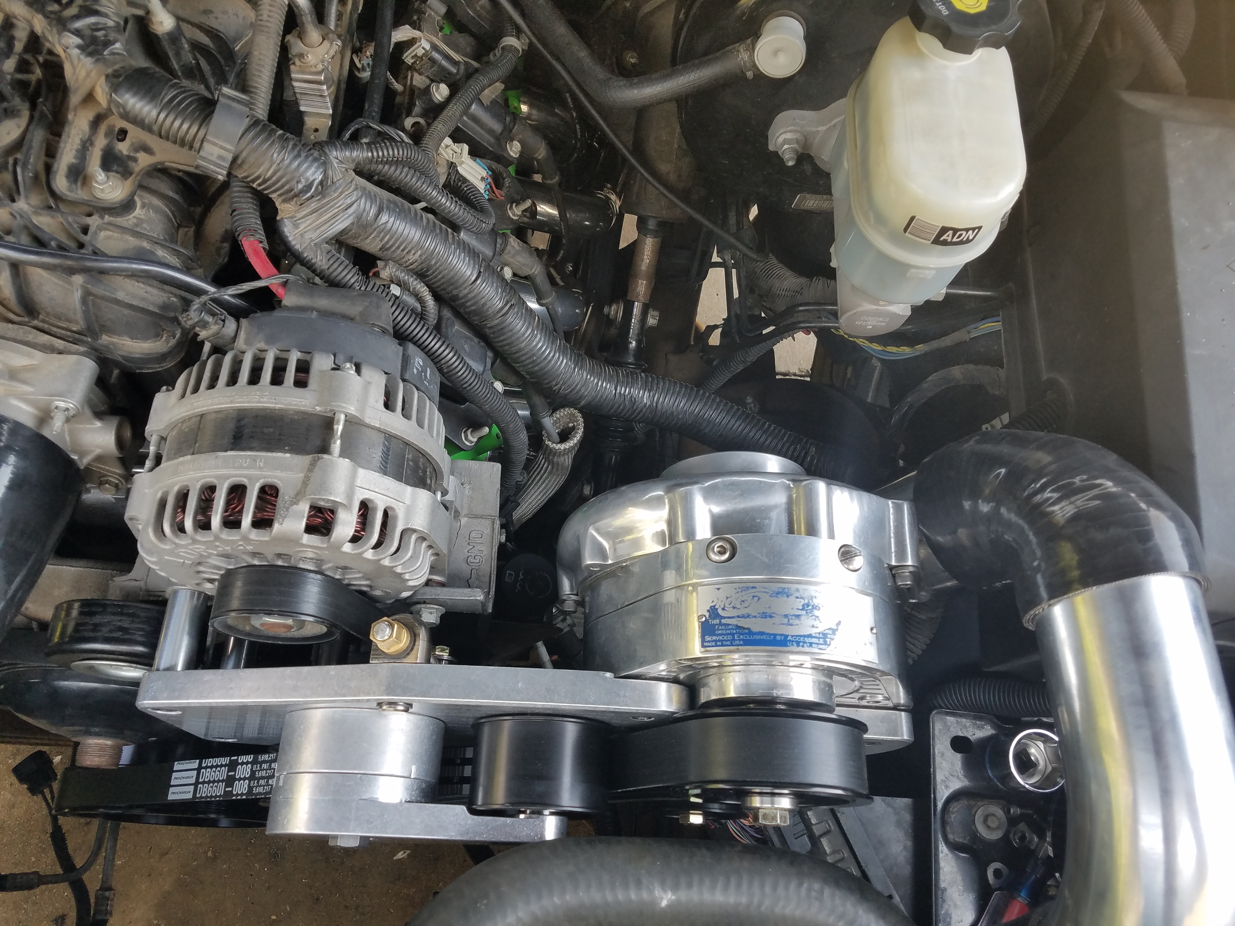

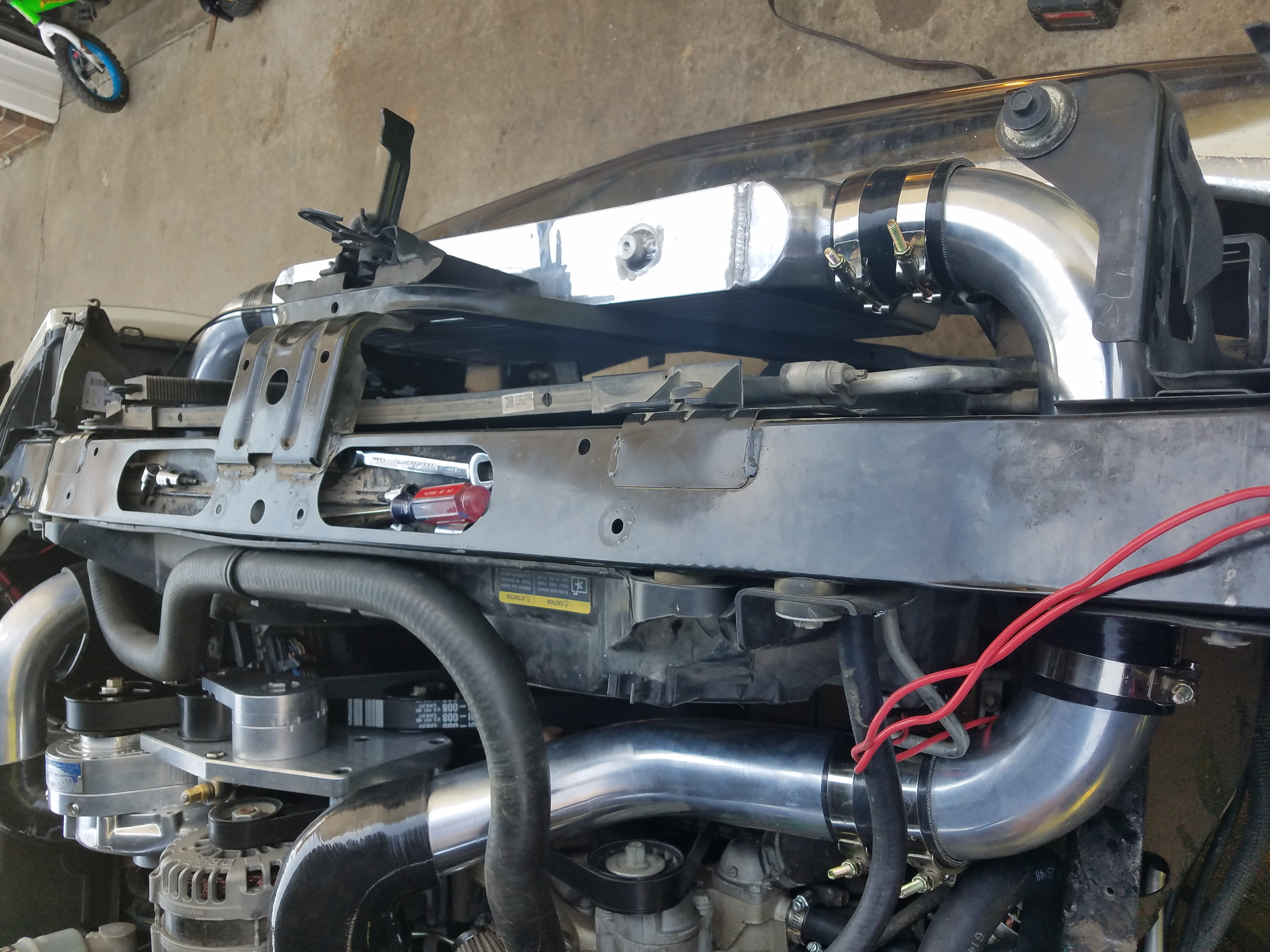

Well, install is pretty straight forward. Good instructions come with it so not going into a lot of detail.
Truck is up and running, I need to get my walbro 450 in as I've already hit over 100% injector duty cycle on 12 lbs with 93 pump Gas and bosch 650cc injectors. but it does feel pretty good and sounds amazing with the tial Q 50mm bov
But I do have some more eye candy for yall.
Attached Thumbnails Procharger standard bracket vs stage 2?-20170320_121032.jpg   Procharger standard bracket vs stage 2?-20170320_121002.jpg   Procharger standard bracket vs stage 2?-20170320_120954.jpg   Procharger standard bracket vs stage 2?-20170320_120931.jpg   Procharger standard bracket vs stage 2?-20170320_120908.jpg

It's a cx racing universal kit off ebay. 3" bar and plate core and 3" in/outlets. I don't mind questions, just didn't think there's much to say about installing it. 3 alternator/power sting pump bracket bolts and one alternator bolt come off, 4 spacers and 4 new bolts go on.
But I will say it's a nice bracket. I did have to shim the pulley out with three machine bushings to clear the bracket. Picked them up from a local atwoods for a few cents each, other wise an "ATI procharger shim" is $7+ for a package of 2 shims.
