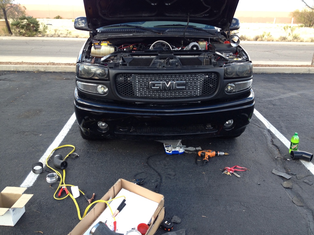

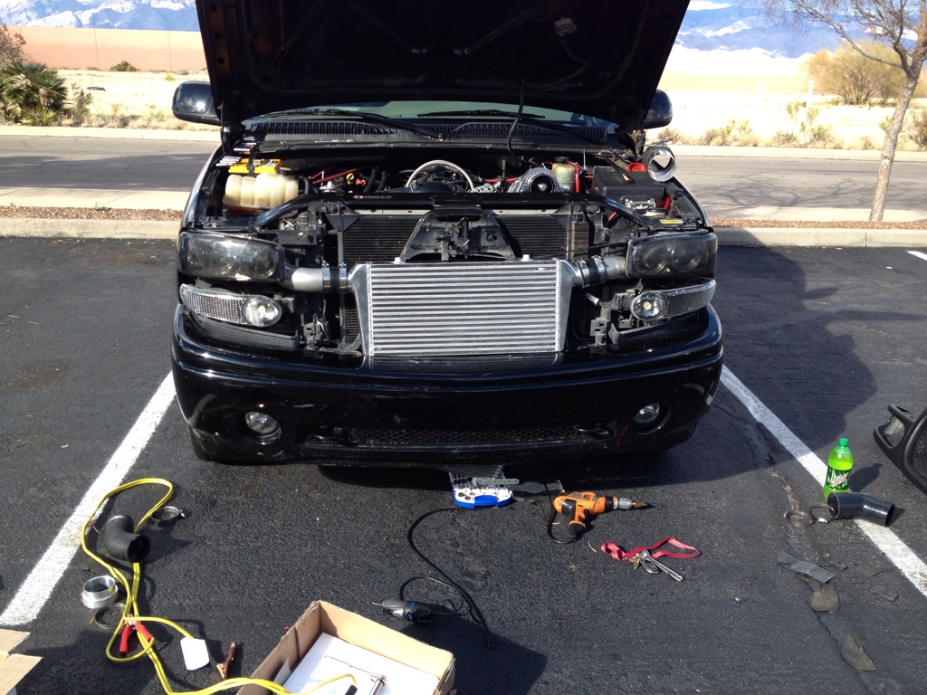

go with a normal Front mount intercooler. will be easier to mount. here is my 31x12x3

I used a lot of the stock procharger pipes. You have to cut a lot of the headlight bracket to make it fit but it will

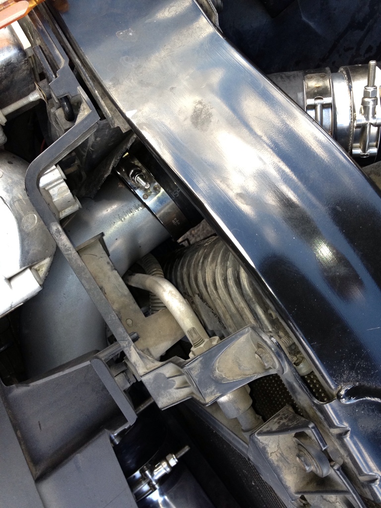

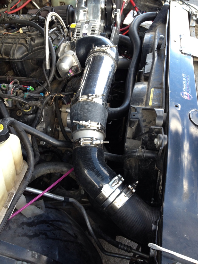

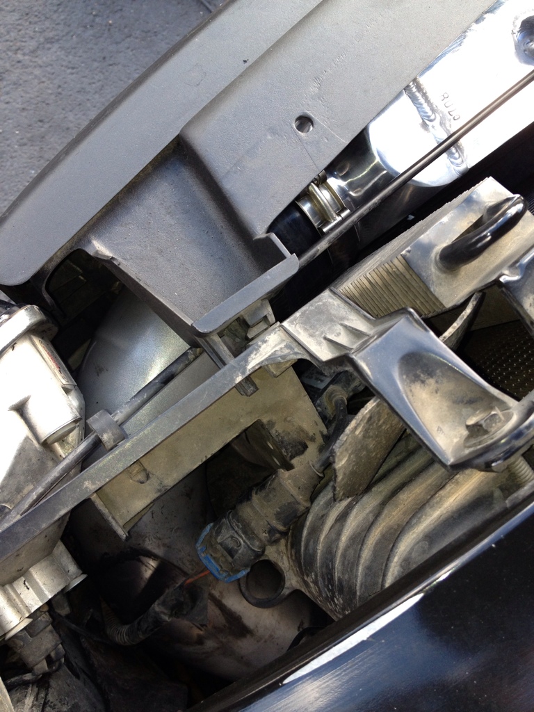

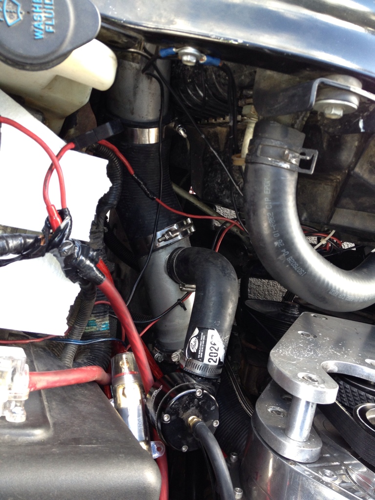

Here's how mine is routes
