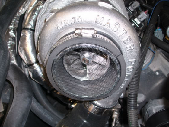

A guy on ebay sell filter screens for $20 shipped. They fit and look pretty good.
That's a Fernco coupler for PVC pipe and some screen door mesh. Just go to Home Depot or Lowe's.
