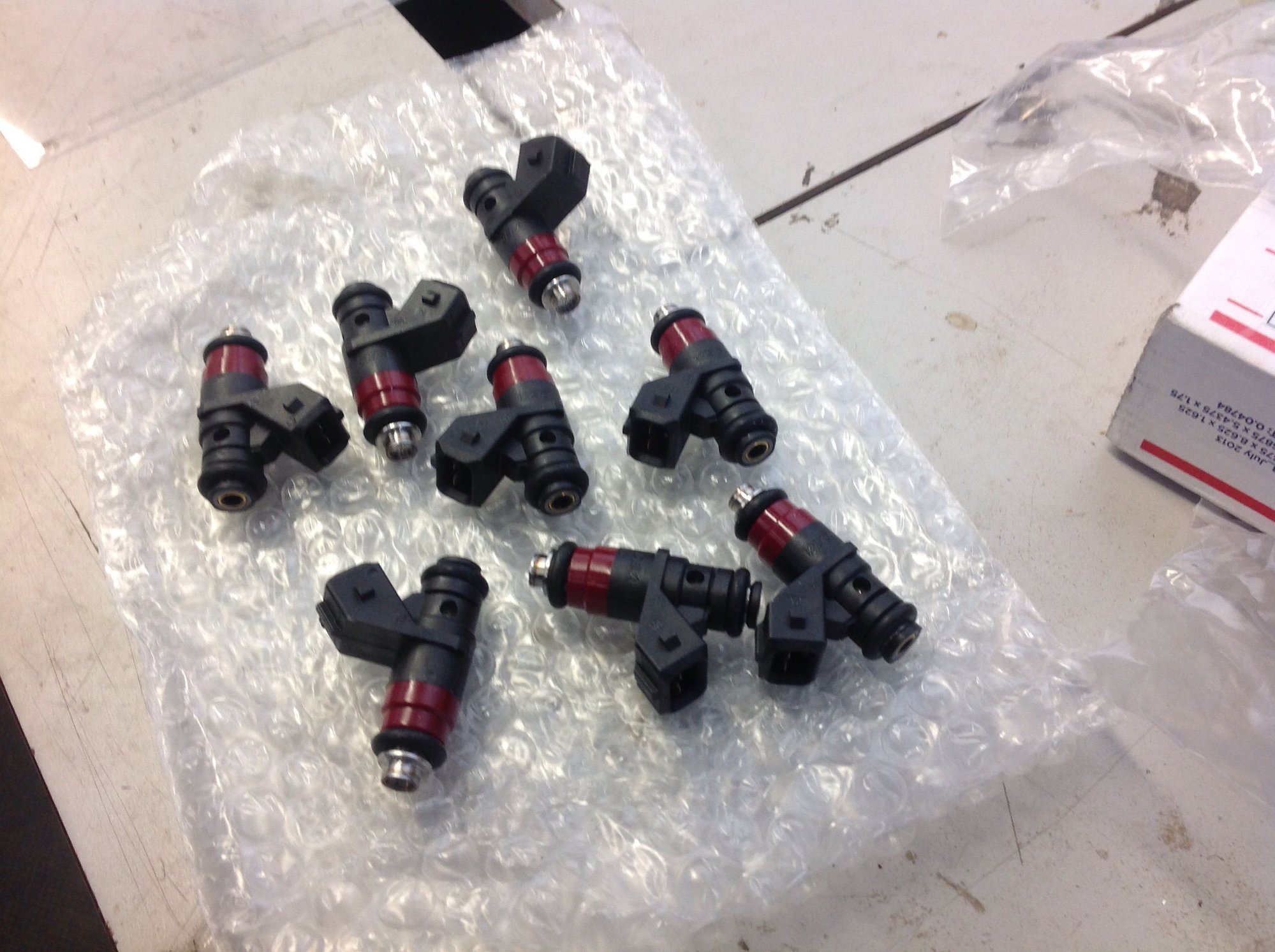

So many problems, only the injectors are my fault, since I did not check them sooner
I had these for months and the plug is wrong

The injector where a little short 48mm and I found out I needed, injector hats 12mm longer to work with the stock rails. Also the plug was not so wrong, needed a Delphi to EV1 adapter.. Learning a lot since this was my first install of a Supercharger.
