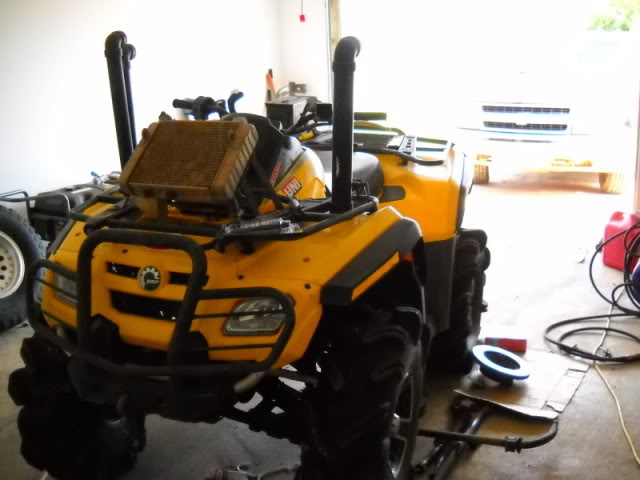

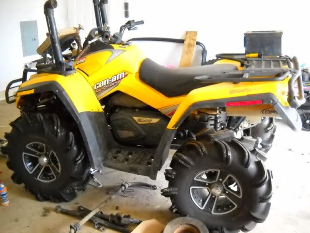

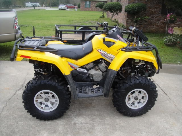

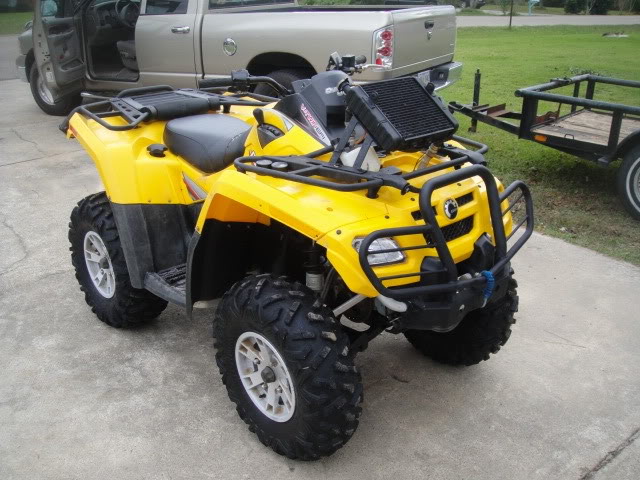

i have a dangerous mind... cost me lots of money...look at my 4 wheeler (since i have started my truck build)
NOTICE HOW MANY DIFFERENT TIRE/WHELL COMBO's...lol
