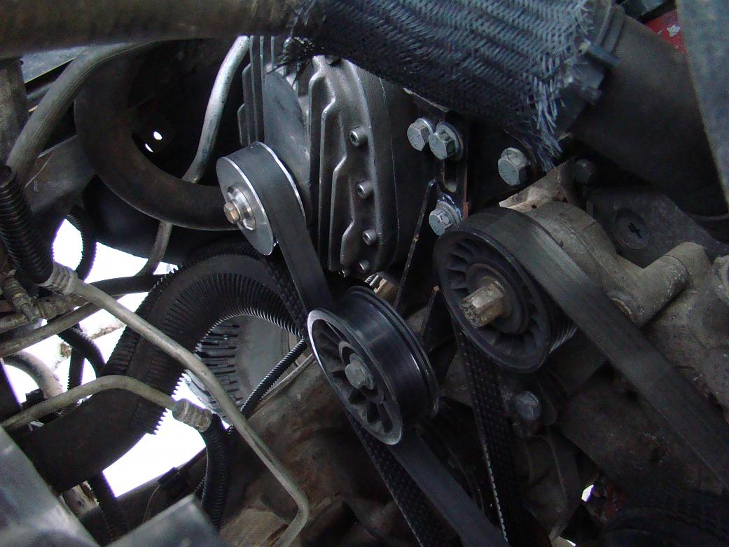

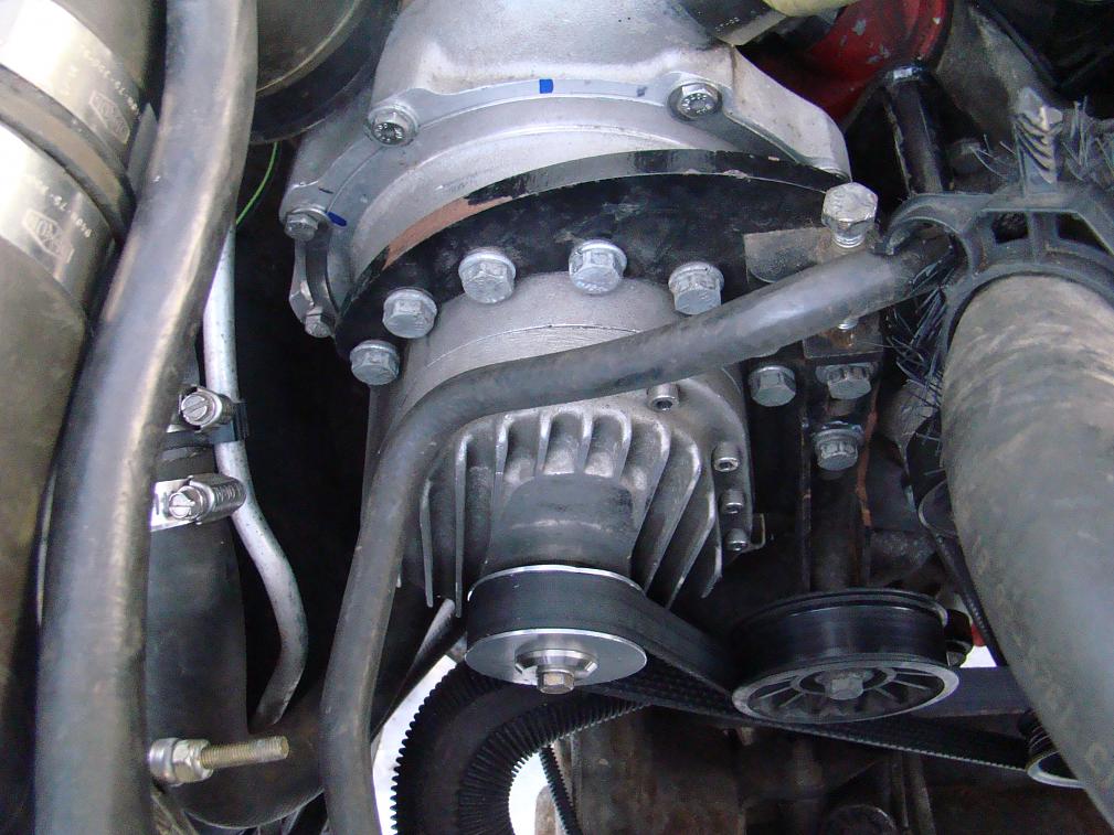

Here are a couple pics of tensioner setup.

what lift is that cam.. I would put what ever springs you have on the 6.0 on the stock heads if you swap them back over... Your belt looks like it has a good bit of wrap, but its worth a shot..
My belt warp before I swapped pulleys around
After I changed them.. ( note only reason that pulley is aluminum looking, is because the orig one ate the bearings up, I had to make a new on)
