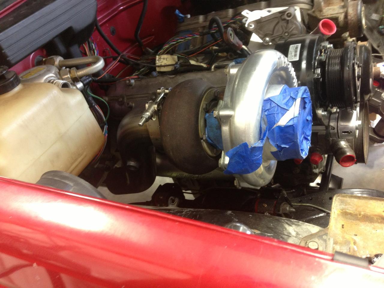

This is Tricks new hot parts kit on mine.
Im waiting on the new cast T6 manifold to finish up my setup.

So every thing clears the over flow tank?
Old Jul 3, 2014 | 12:39 PM
TrickTurbo's Avatar
Truck Sponsor
Joined: Sep 2006
Posts: 4,466
Likes: 62
From: Wichita Falls Tx.
Yes. It cleared.
The heater hoses will need formed 90's off the core.
So they don't get kinked, and looks better.

Yes we have. The kits are not on the site yet.
I wanted to have a few sets built prior to officially saying we have them.
The pipes are stainless steel.
There will be more weld joints in the down pipe.
Compared to the current NBS stuff we do
Crossover will have the flex/slip joint.
Manifold is the cast stainless steel manifold.
Waste gate will vent back into the down pipe.
Complete hot pipe kit will include the gaskets, studs and nuts.
Fits mid T4 turbos, precision, tnetics, magnum etc.
