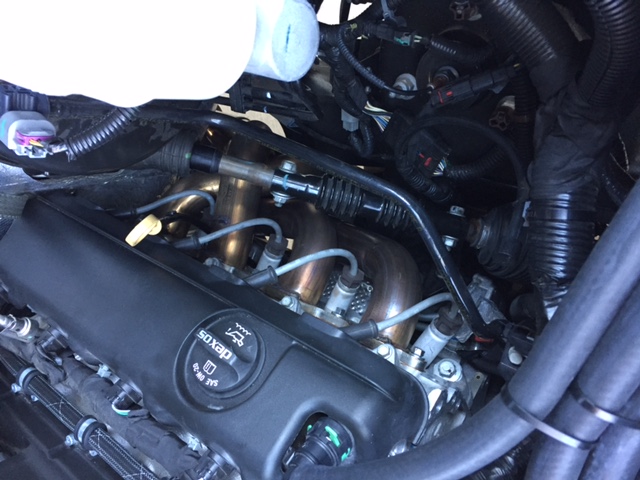

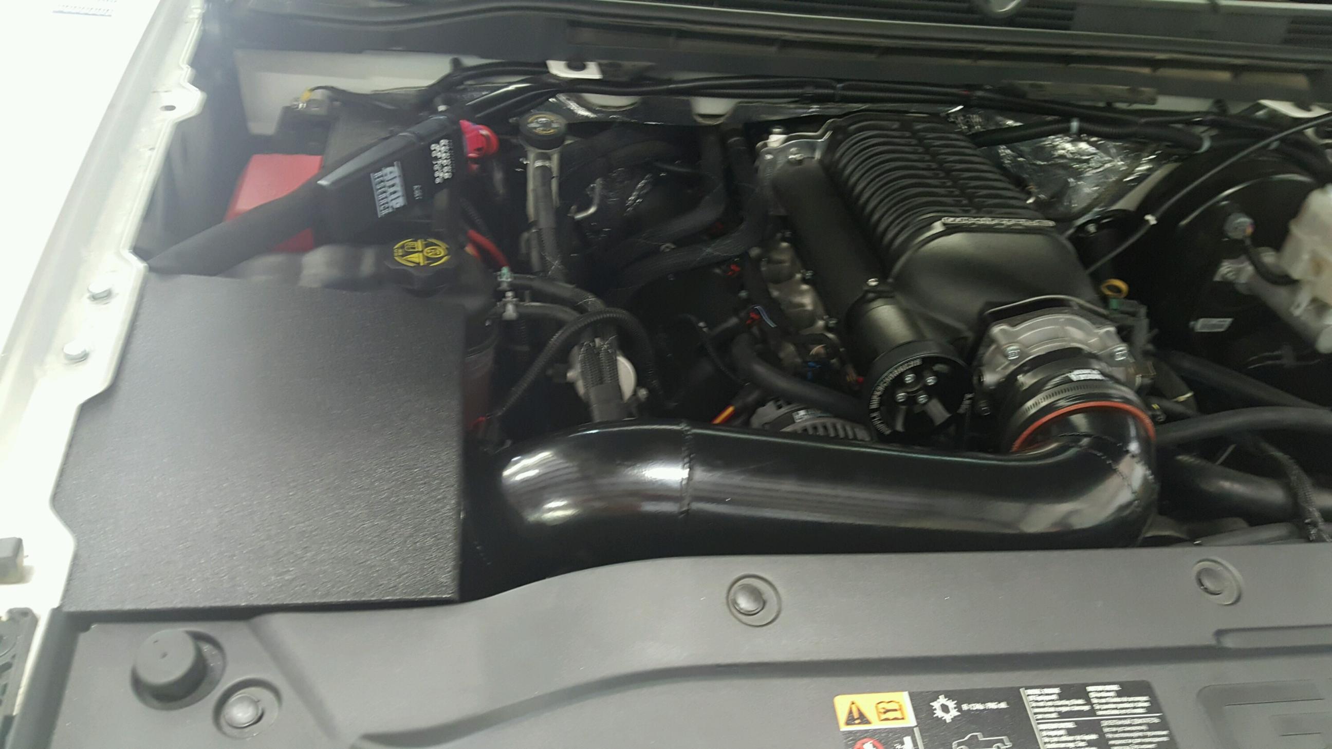

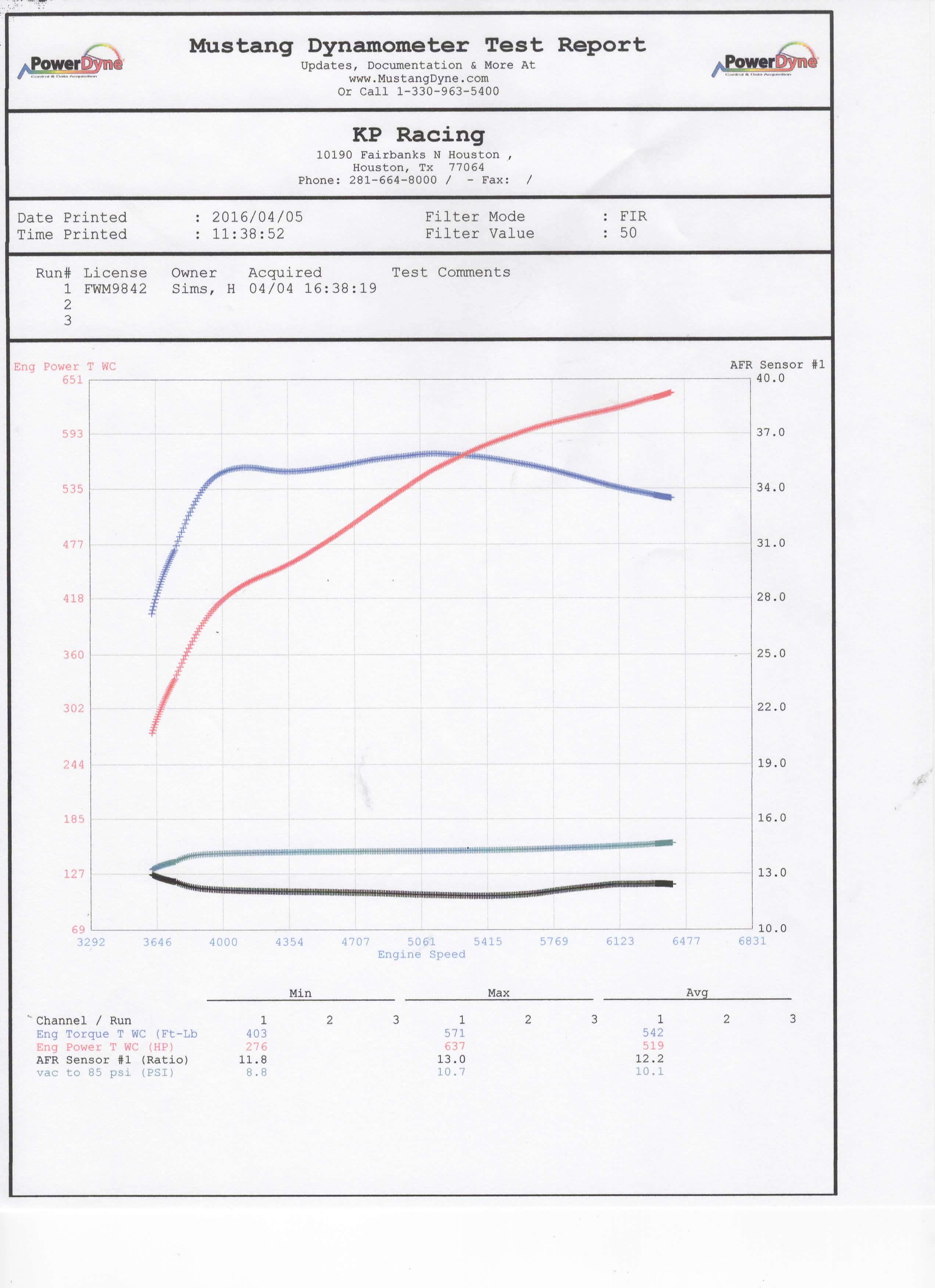

3.625 pulley
No meth
New fuel pump and injectors
2 inch American \Racing Headers and high flow cats
4.5 inch KP cold air
Cam XA 224-334-236-330
Intake lift .602
Intake duration 224
Exhaust lift 594
Duration 336
637 RWHP
571 TQ
KP Racing Tune
Not trying to Hi Jack just giving my basic set up and numbers.
Im still struggling with tuning issues...Data logging now

Alot of info still missing.
1. What is your psi?
2. Engine size, specs, etc?
Great numbers.

Default 6.2 Whipple
2015 6.2 4x4 Denali.

Ahhhhh,
There we go. Apples and oranges comparison. The new DI motors respond to boost very very well. Your Whipple is probably a 2.9L as well.
I have a baby cam in mine. I had a boost cam spec'd but haven't ordered it yet.

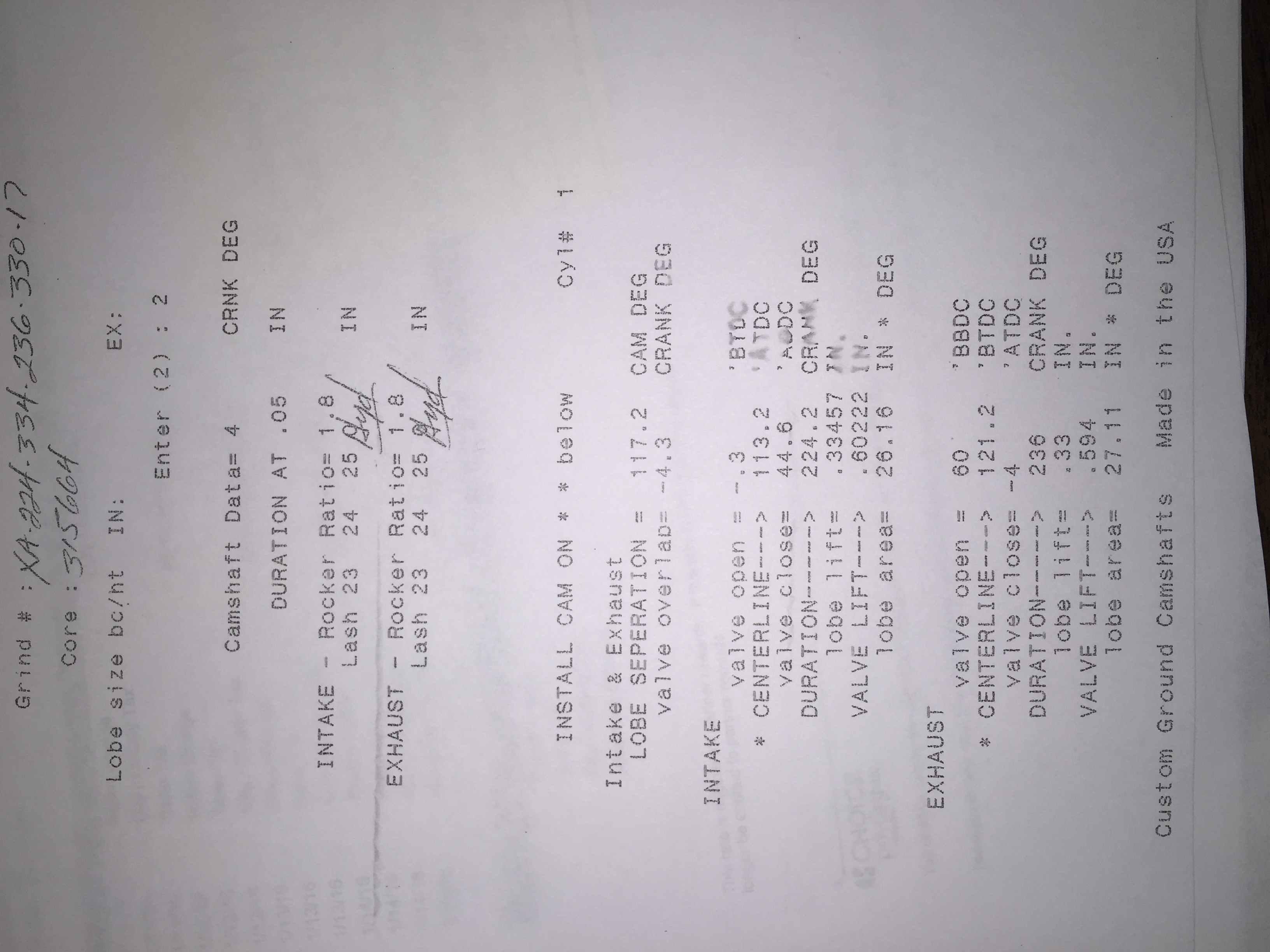

Default Here is the Cam Card if your interested
Great little cam
