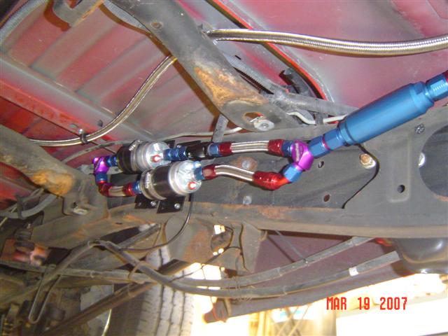

You definitely need the copper washers(no rubber o-rings).
Make sure you got a fuel pressure gauge on there under boost.I've seen a few inlines suck the stock pump dry and pressure drops big time.
Sucks on the flat bottom truck tanks but it might be better to drill the back corner and run that pump parallel and boost sensative.
You could always run 2
Attached Thumbnails Picked up the new Bosch 044 inline pump yesterday-dsc02844.jpg
Old Jan 22, 2009 | 03:10 PM
  #50
MikeGyver's Avatar
Joined: Jun 2005
Posts: 4,520
Likes: 244
From: Suburban Chicago
That's like $1000 worth of stuff in that picture, isn't it?
